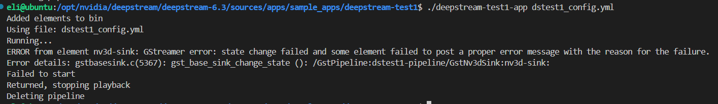

Yeah, I have tried and got this error,

Is there a physical monitor connected with your board? What happened after you changing the sink to fakesink?
No, I don’t have a monitor.
I didn’t change the sink and where can I change that?
Please open the /opt/nvidia/deepstream/deepstream/sources/apps/sample_apps/deepstream-test1/deepstream_test1_app.c and change the following code:

if(prop.integrated) {
sink = gst_element_factory_make("fakesink", "nv3d-sink");
} else {
Then you can build the sample app and use it.
Yeah, Now I can run the sample app
