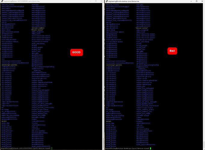

I have few Orin NX and Orin Nano Soms Flashed with Jetpack 5.1.2.
When I try to read the serial number some of my som’s are having the Serial number node in the device tree and some are not having the Serial number node when the same image is flashed.
I am attaching the Image of the same and the eeprom dump. When i change the starting bit of the eeprom on the SOM’s whose serial number are not available in the devicetree with the ones I am getting the serial number.

Hi @WayneWWW
If you look at the screenshot of the eeprom dump its marked as good and bad. The Good is the one that is giving the serial number in DTB.
If you check at the starting bit row 00: 02 00 fe
In the other one it is 00: ff f3 38
If we change the ff of bad eeprom to 02 00 we will get the serial number properly in the device-tree.
ie the if I change the eeprom data of bad to 00: 02 00 38 it will work
