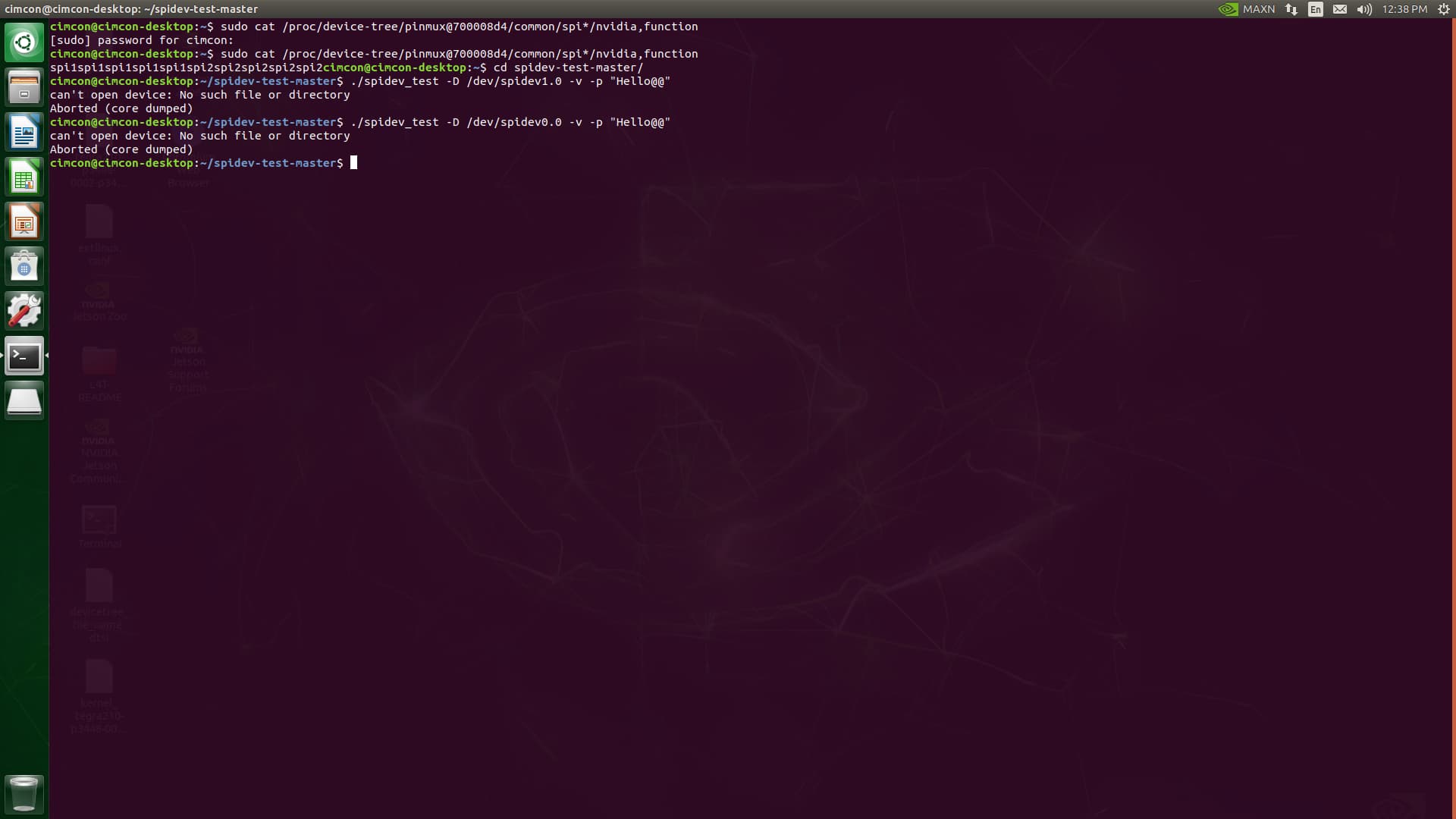

Hi shane thank you for your response I have got bit different output than yours, please tell me where all the necessary changes should i make in my dtsi file i have modified nvidia,function = spi* at different points .
cimcon@cimcon-desktop:~$ sudo cat /proc/device-tree/pinmux@700008d4/common/spi*/nvidia,function
spi1spi1spi0spi0spi1rsvd2rsvd1rsvd2rsvd2rsvd2cimcon@cimcon-desktop:
This is what the output i am receiving

The configure should be good for SPI1 aka spidev0.0 from your REG dump. Did you short pin19 &21 to run the spidev_test?

Please run with sudo also check if the /dev/spidev0.0 was created.
If the /dev/spidev0.0 didn’t present you need below command to create it first.
sudo modprobe spidev
nvidia@nvidia-desktop:~$ ./spidev_test -D /dev/spidev0.0 -g32 -s 11000000 -p0  -zzz

Hi shane
when I enter
$ ls /dev/spi* it shows all the spi present
later it fails to perform the loopback testing
cimcon@cimcon-desktop:~/spidev-test-master$ sudo modprobe spidev
cimcon@cimcon-desktop:~/spidev-test-master$ ls /dev/spi
ls: cannot access ‘/dev/spi’: No such file or directory
cimcon@cimcon-desktop:~/spidev-test-master$ ls /dev/spi*
/dev/spidev0.0 /dev/spidev0.1 /dev/spidev1.0 /dev/spidev1.1
cimcon@cimcon-desktop:~/spidev-test-master$ ls /dev/spidev0.0
/dev/spidev0.0
