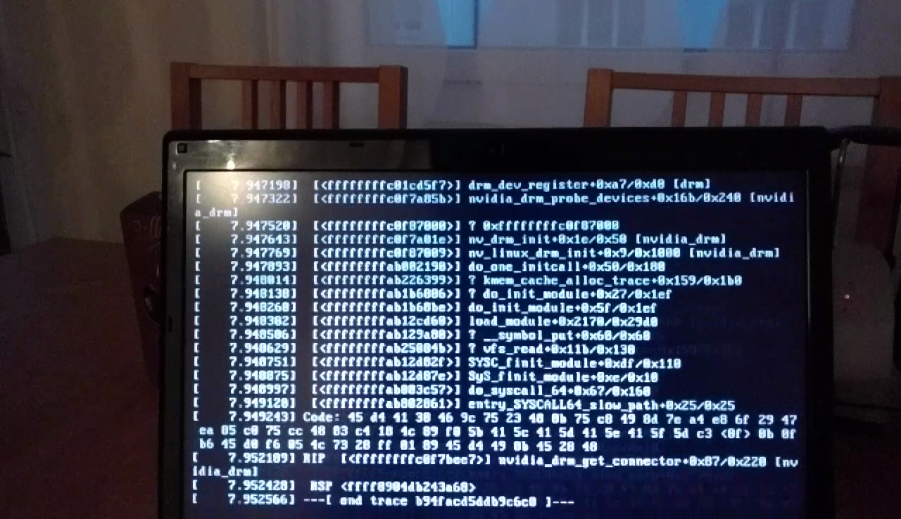

Please provide reproduction steps. Also nvidia bug report. Please copy stacktrace to any text file and attach to you first comment. Is any latest or earlier nvidia driver help to resolve this issue?
Reproduction steps:
  1. Install Fedora 25 x86_64
  2. Install nvidia driver from RPM Fusion
  3. Enable plymouth KMS as per http://blog.sukimashita.com/2016/05/02/graphical-boot-plymouth-opensuse-nvidia-364-driver/
  4. Reboot
I am afraid I cannot provide a text stack trace - it happens at boot so I do not have a functioning system at this point yet. I will attach an nvidia bug report without KMS (only way I can boot). 375.20 is the only packaged driver for fedora 25 at this point.
I tried this again with Fedora 26 and nvidia driver 384.59. While I still don’t have the text log, I was able to switch my console to higher resolution so that more can be seen at once. Please find the updated screenshot and nvidia-bug-report.log when running without modesetting attached.

In order to reproduce the issue, all is needed is installation of nvidia driver from RPM Fusion as it enables modesetting by default in Fedora 27 and above (it is no longer necessary to follow the instructions from the blog from post #1). The good news is that I was able to get the backtrace in text format:
kernel BUG at /tmp/akmodsbuild.pVaUrXmw/BUILD/nvidia-kmod-390.25/_kmod_build_4.15.3-300.fc27.x86_64/nvidia-drm/nvidia-drm-connector.c:425!
invalid opcode: 0000 [#1] SMP PTI
Modules linked in: arc4 intel_rapl x86_pkg_temp_thermal snd_hda_codec_hdmi intel_powerclamp iwlmvm coretemp nvidia_drm(POE+) nvidia_modeset(POE) mac80211 kvm_intel iTCO_wdt nvidia(POE) snd_hda_codec_realtek iTCO_vendor_support kvm snd_hda_codec_generic uvcvideo videobuf2_vmalloc videobuf2_memops videobuf2_v4l2 snd_hda_intel irqbypass videobuf2_core crct10dif_pclmul crc32_pclmul iwlwifi snd_hda_codec videodev drm_kms_helper ghash_clmulni_intel intel_cstate snd_hda_core intel_uncore snd_hwdep snd_seq media cfg80211 intel_rapl_perf snd_seq_device drm snd_pcm joydev ipmi_devintf wmi_bmof ipmi_msghandler snd_timer jmb38x_ms rfkill i2c_i801 snd mei_me memstick mei soundcore shpchp lpc_ich binfmt_misc crc32c_intel firewire_ohci serio_raw sdhci_pci firewire_core sdhci mmc_core crc_itu_t jme mii
 wmi video
CPU: 7 PID: 672 Comm: systemd-udevd Tainted: P           OE    4.15.3-300.fc27.x86_64 #1
Hardware name: CLEVO                             P150HMx/P150HMx, BIOS 4.6.4 08/09/2011
RIP: 0010:nv_drm_get_connector+0x92/0x1b0 [nvidia_drm]
RSP: 0018:ffffa37e41f8fac8 EFLAGS: 00010297
RAX: 0000000000000001 RBX: 0000000000000000 RCX: 0000000000000001
RDX: 0000000000000000 RSI: 0000000000000008 RDI: ffff97401cde0800
RBP: ffff97401e26d2f8 R08: ffff97401d19f6c8 R09: 000000000000000f
R10: 0000000000000580 R11: ffff97401e5a1900 R12: 0000000000000000
R13: ffff97401e26d000 R14: 0000000000000008 R15: ffff97401cde0868
FS:  00007f65905771c0(0000) GS:ffff97402f5c0000(0000) knlGS:0000000000000000
CS:  0010 DS: 0000 ES: 0000 CR0: 0000000080050033
CR2: 00005624259a4020 CR3: 000000031e982003 CR4: 00000000000606e0
Call Trace:
 nv_drm_add_encoder+0x1a1/0x320 [nvidia_drm]
 nv_drm_load+0x26c/0x370 [nvidia_drm]
 ? nv_drm_output_poll_changed+0xa0/0xa0 [nvidia_drm]
 drm_dev_register+0x132/0x1c0 [drm]
 nv_drm_probe_devices+0x11e/0x230 [nvidia_drm]
 ? 0xffffffffc0599000
 do_one_initcall+0x4e/0x190
 ? free_unref_page_commit+0x9f/0x110
 ? _cond_resched+0x15/0x40
 ? kmem_cache_alloc_trace+0xac/0x1b0
 ? do_init_module+0x22/0x201
 do_init_module+0x5b/0x201
 load_module+0x26b1/0x2b60
 ? vfs_read+0x113/0x130
 ? SYSC_finit_module+0xe9/0x110
 do_syscall_64+0x75/0x180
 entry_SYSCALL_64_after_hwframe+0x21/0x86
RIP: 0033:0x7f658fea6bf9
RSP: 002b:00007ffd7e167fe8 EFLAGS: 00000246 ORIG_RAX: 0000000000000139
RAX: ffffffffffffffda RBX: 0000562425985fe0 RCX: 00007f658fea6bf9
RDX: 0000000000000000 RSI: 000056242599c600 RDI: 0000000000000016
RBP: 000056242599c600 R08: 0000000000000000 R09: 00007ffd7e168100
R10: 0000000000000016 R11: 0000000000000246 R12: 0000000000000000
R13: 0000562425979080 R14: 0000000000020000 R15: 0000000000000000
Code: 44 24 0b 38 47 04 75 23 48 8b 34 24 48 83 c7 0c e8 24 e5 1d f5 85 c0 75 c3 48 83 c4 10 4c 89 f8 5b 5d 41 5c 41 5d 41 5e 41 5f c3 <0f> 0b be 78 04 00 00 bf 01 00 00 00 4d 8b 65 28 e8 09 11 00 00
RIP: nv_drm_get_connector+0x92/0x1b0 [nvidia_drm] RSP: ffffa37e41f8fac8

As mentioned, all that is needed to reproduce this issue is to run
# dnf install akmod-nvidia
as on the current Fedora releases modesetting is enabled by default. Setting
nvidia-drm.modeset=0
solves the problem for me. This needs to be something specific to this particular configuration as my other computer works fine with modeset enabled.

[    4.533727] registered taskstats version 1
[    4.533750] Loading compiled-in X.509 certificates
[    4.536430] Loaded X.509 cert 'Fedora kernel signing key: 73bb7f1860e8f87034edbe9fa50b0f5dc122b01e'
[    4.536504] zswap: loaded using pool lzo/zbud
[    4.537124] Key type ._fscrypt registered
[    4.537125] Key type .fscrypt registered
[    4.537125] Key type fscrypt-provisioning registered
[    4.537293] Btrfs loaded, crc32c=crc32c-generic
[    4.543991] Key type encrypted registered
[    4.544010] ima: No TPM chip found, activating TPM-bypass!
[    4.544026] ima: Allocated hash algorithm: sha256
[    4.544053] ima: No architecture policies found
[    4.544457] PM:   Magic number: 4:689:421
[    4.544685] RAS: Correctable Errors collector initialized.
[    4.764523] ata1: SATA link up 6.0 Gbps (SStatus 133 SControl 300)
[    4.766365] ata1.00: supports DRM functions and may not be fully accessible
[    4.767343] ata1.00: disabling queued TRIM support
[    4.767348] ata1.00: ATA-9: Samsung SSD 850 EVO 500GB, EMT02B6Q, max UDMA/133
[    4.767352] ata1.00: 976773168 sectors, multi 1: LBA48 NCQ (depth 32), AA
[    4.769291] ata1.00: supports DRM functions and may not be fully accessible
[    4.770045] ata1.00: disabling queued TRIM support
[    4.771012] ata1.00: configured for UDMA/133
[    4.781761] scsi 0:0:0:0: Direct-Access     ATA      Samsung SSD 850  2B6Q PQ: 0 ANSI: 5
[    4.782306] sd 0:0:0:0: Attached scsi generic sg0 type 0
[    4.782652] sd 0:0:0:0: [sda] 976773168 512-byte logical blocks: (500 GB/466 GiB)
[    4.782684] sd 0:0:0:0: [sda] Write Protect is off
[    4.782689] sd 0:0:0:0: [sda] Mode Sense: 00 3a 00 00
[    4.782734] sd 0:0:0:0: [sda] Write cache: enabled, read cache: enabled, doesn't support DPO or FUA
[    4.783551] usb 1-1: new high-speed USB device number 2 using ehci-pci
[    4.784361]  sda: sda1 sda2 sda3 sda4 < sda5 >
[    4.786299] sd 0:0:0:0: [sda] supports TCG Opal
[    4.786305] sd 0:0:0:0: [sda] Attached SCSI disk
[    4.799546] usb 2-1: new high-speed USB device number 2 using ehci-pci
[    4.987324] usb 2-1: New USB device found, idVendor=8087, idProduct=0024, bcdDevice= 0.00
[    4.987330] usb 2-1: New USB device strings: Mfr=0, Product=0, SerialNumber=0
[    4.987446] usb 1-1: New USB device found, idVendor=8087, idProduct=0024, bcdDevice= 0.00
[    4.987449] usb 1-1: New USB device strings: Mfr=0, Product=0, SerialNumber=0
[    4.987968] hub 2-1:1.0: USB hub found
[    4.988046] hub 1-1:1.0: USB hub found
[    4.988100] hub 2-1:1.0: 6 ports detected
[    4.988244] hub 1-1:1.0: 6 ports detected
[    5.093490] ata3: SATA link up 1.5 Gbps (SStatus 113 SControl 300)
[    5.104635] ata3.00: ATAPI: HL-DT-ST BDDVDRW CT30N, WM01, max UDMA/133
[    5.108480] ata3.00: configured for UDMA/133
[    5.112354] scsi 2:0:0:0: CD-ROM            HL-DT-ST BDDVDRW CT30N    WM01 PQ: 0 ANSI: 5
[    5.251383] sr 2:0:0:0: [sr0] scsi3-mmc drive: 24x/24x writer dvd-ram cd/rw xa/form2 cdda tray
[    5.251387] cdrom: Uniform CD-ROM driver Revision: 3.20
[    5.332515] usb 2-1.5: new full-speed USB device number 3 using ehci-pci
[    5.333257] sr 2:0:0:0: Attached scsi CD-ROM sr0
[    5.333451] sr 2:0:0:0: Attached scsi generic sg1 type 5
[    5.470121] usb 2-1.5: New USB device found, idVendor=147e, idProduct=1001, bcdDevice= 0.43
[    5.470126] usb 2-1.5: New USB device strings: Mfr=1, Product=2, SerialNumber=0
[    5.470129] usb 2-1.5: Product: Fingerprint Sensor
[    5.470131] usb 2-1.5: Manufacturer: TouchStrip
[    5.643676] ata4: SATA link down (SStatus 0 SControl 300)
[    5.698795] Freeing unused decrypted memory: 2040K
[    5.700043] Freeing unused kernel image (initmem) memory: 2504K
[    5.700192] Write protecting the kernel read-only data: 26624k
[    5.701858] Freeing unused kernel image (text/rodata gap) memory: 2044K
[    5.702904] Freeing unused kernel image (rodata/data gap) memory: 1628K
[    5.848548] psmouse serio2: synaptics: queried max coordinates: x [..5692], y [..4680]
[    5.878327] x86/mm: Checked W+X mappings: passed, no W+X pages found.
[    5.878335] rodata_test: all tests were successful
[    5.878338] x86/mm: Checking user space page tables
[    5.924460] x86/mm: Checked W+X mappings: passed, no W+X pages found.
[    5.924497] Run /init as init process
[    5.924499]   with arguments:
[    5.924499]     /init
[    5.924500]     rhgb
[    5.924500]   with environment:
[    5.924501]     HOME=/
[    5.924501]     TERM=linux
[    5.924502]     BOOT_IMAGE=(hd0,msdos3)/vmlinuz-5.8.6-201.fc32.x86_64
[    5.938510] systemd[1]: systemd v245.7-1.fc32 running in system mode. (+PAM +AUDIT +SELINUX +IMA -APPARMOR +SMACK +SYSVINIT +UTMP +LIBCRYPTSETUP +GCRYPT +GNUTLS +ACL +XZ +LZ4 +SECCOMP +BLKID +ELFUTILS +KMOD +IDN2 -IDN +PCRE2 default-hierarchy=unified)
[    5.950840] systemd[1]: Detected architecture x86-64.
[    5.950851] systemd[1]: Running in initial RAM disk.
[    5.950974] systemd[1]: Set hostname to <snowball2>.
[    5.999861] psmouse serio2: synaptics: Touchpad model: 1, fw: 7.2, id: 0x1c0b1, caps: 0xd04731/0xa40000/0xa0000/0x0, board id: 0, fw id: 582762
[    6.020546] random: fast init done
[    6.041392] input: SynPS/2 Synaptics TouchPad as /devices/platform/i8042/serio2/input/input10
[    6.048833] random: systemd: uninitialized urandom read (16 bytes read)
[    6.048844] systemd[1]: Reached target Local File Systems.
[    6.048888] random: systemd: uninitialized urandom read (16 bytes read)
[    6.048894] systemd[1]: Reached target Slices.
[    6.048905] random: systemd: uninitialized urandom read (16 bytes read)
[    6.048911] systemd[1]: Reached target Swap.
[    6.048925] systemd[1]: Reached target Timers.
[    6.049053] systemd[1]: Listening on Journal Audit Socket.
[    6.049133] systemd[1]: Listening on Journal Socket (/dev/log).
[    6.049222] systemd[1]: Listening on Journal Socket.
[    6.049298] systemd[1]: Listening on udev Control Socket.
[    6.049353] systemd[1]: Listening on udev Kernel Socket.
[    6.049369] systemd[1]: Reached target Sockets.
[    6.050837] systemd[1]: Starting Create list of static device nodes for the current kernel...
[    6.051425] systemd[1]: Started Hardware RNG Entropy Gatherer Daemon.
[    6.052825] systemd[1]: Starting Journal Service...
[    6.053575] systemd[1]: Starting Load Kernel Modules...
[    6.054326] systemd[1]: Starting Setup Virtual Console...
[    6.055093] systemd[1]: Finished Create list of static device nodes for the current kernel.
[    6.055902] systemd[1]: Starting Create Static Device Nodes in /dev...
[    6.062423] systemd[1]: Finished Create Static Device Nodes in /dev.
[    6.103682] systemd[1]: Finished Setup Virtual Console.
[    6.103736] audit: type=1130 audit(1599380806.115:2): pid=1 uid=0 auid=4294967295 ses=4294967295 subj=kernel msg='unit=systemd-vconsole-setup comm="systemd" exe="/usr/lib/systemd/systemd" hostname=? addr=? terminal=? res=success'
[    6.103918] systemd[1]: Condition check resulted in dracut ask for additional cmdline parameters being skipped.
[    6.104854] systemd[1]: Starting dracut cmdline hook...
[    6.129102] fuse: init (API version 7.31)
[    6.130232] systemd[1]: Finished Load Kernel Modules.
[    6.131224] systemd[1]: Starting Apply Kernel Variables...
[    6.131257] audit: type=1130 audit(1599380806.141:3): pid=1 uid=0 auid=4294967295 ses=4294967295 subj=kernel msg='unit=systemd-modules-load comm="systemd" exe="/usr/lib/systemd/systemd" hostname=? addr=? terminal=? res=success'
[    6.140185] systemd[1]: Finished Apply Kernel Variables.
[    6.140369] systemd[1]: Started Journal Service.
[    6.141350] audit: type=1130 audit(1599380806.151:4): pid=1 uid=0 auid=4294967295 ses=4294967295 subj=kernel msg='unit=systemd-sysctl comm="systemd" exe="/usr/lib/systemd/systemd" hostname=? addr=? terminal=? res=success'
[    6.141353] audit: type=1130 audit(1599380806.151:5): pid=1 uid=0 auid=4294967295 ses=4294967295 subj=kernel msg='unit=systemd-journald comm="systemd" exe="/usr/lib/systemd/systemd" hostname=? addr=? terminal=? res=success'
[    6.153034] audit: type=1130 audit(1599380806.164:6): pid=1 uid=0 auid=4294967295 ses=4294967295 subj=kernel msg='unit=systemd-tmpfiles-setup comm="systemd" exe="/usr/lib/systemd/systemd" hostname=? addr=? terminal=? res=success'
[    6.205131] audit: type=1130 audit(1599380806.215:7): pid=1 uid=0 auid=4294967295 ses=4294967295 subj=kernel msg='unit=dracut-cmdline comm="systemd" exe="/usr/lib/systemd/systemd" hostname=? addr=? terminal=? res=success'
[    6.237117] audit: type=1130 audit(1599380806.248:8): pid=1 uid=0 auid=4294967295 ses=4294967295 subj=kernel msg='unit=dracut-pre-udev comm="systemd" exe="/usr/lib/systemd/systemd" hostname=? addr=? terminal=? res=success'
[    6.237577] audit: type=1334 audit(1599380806.249:9): prog-id=6 op=LOAD
[    6.237622] audit: type=1334 audit(1599380806.249:10): prog-id=7 op=LOAD
[    6.283636] audit: type=1130 audit(1599380806.295:11): pid=1 uid=0 auid=4294967295 ses=4294967295 subj=kernel msg='unit=systemd-udevd comm="systemd" exe="/usr/lib/systemd/systemd" hostname=? addr=? terminal=? res=success'
[    6.396945] video: probe of PNP0A08:00 failed with error -22
[    6.396979] [Firmware Bug]: ACPI(MXM3) defines _DOD but not _DOS
[    6.397148] ACPI: Video Device [MXM3] (multi-head: yes  rom: no  post: no)
[    6.399025] acpi device:1a: registered as cooling_device8
[    6.399074] input: Video Bus as /devices/LNXSYSTM:00/LNXSYBUS:00/PNP0A08:00/device:18/LNXVIDEO:00/input/input13
[    6.471603] jme: JMicron JMC2XX ethernet driver version 1.0.8
[    6.471630] jme 0000:03:00.0: can't disable ASPM; OS doesn't have ASPM control
[    6.475659] jme 0000:03:00.0 eth0: JMC250 Gigabit Ethernet chiprev:35 pcirev:5 macaddr:00:90:f5:b9:39:74
[    6.478173] firewire_ohci 0000:05:00.0: overriding IsoXmitIntMask
[    6.490094] sdhci: Secure Digital Host Controller Interface driver
[    6.490095] sdhci: Copyright(c) Pierre Ossman
[    6.506284] sdhci-pci 0000:03:00.1: SDHCI controller found [197b:2392] (rev 90)
[    6.506592] mmc0 bounce up to 128 segments into one, max segment size 65536 bytes
[    6.508798] mmc0: SDHCI controller on PCI [0000:03:00.1] using DMA
[    6.508834] sdhci-pci 0000:03:00.2: SDHCI controller found [197b:2391] (rev 90)
[    6.508905] sdhci-pci 0000:03:00.2: Refusing to bind to secondary interface.
[    6.535559] firewire_ohci 0000:05:00.0: added OHCI v1.10 device as card 0, 4 IR + 4 IT contexts, quirks 0x10
[    6.590730] jme 0000:03:00.0 enp3s0f0: renamed from eth0
[    6.902918] EXT4-fs (dm-1): mounted filesystem with ordered data mode. Opts: (null)
[    7.037586] firewire_core 0000:05:00.0: created device fw0: GUID ea9439b9f5900058, S400
[    7.255801] systemd-journald[252]: Received SIGTERM from PID 1 (systemd).
[    7.492803] SELinux:  Permission watch in class filesystem not defined in policy.
[    7.492808] SELinux:  Permission watch in class file not defined in policy.
[    7.492808] SELinux:  Permission watch_mount in class file not defined in policy.
[    7.492809] SELinux:  Permission watch_sb in class file not defined in policy.
[    7.492810] SELinux:  Permission watch_with_perm in class file not defined in policy.
[    7.492810] SELinux:  Permission watch_reads in class file not defined in policy.
[    7.492813] SELinux:  Permission watch in class dir not defined in policy.
[    7.492814] SELinux:  Permission watch_mount in class dir not defined in policy.
[    7.492814] SELinux:  Permission watch_sb in class dir not defined in policy.
[    7.492815] SELinux:  Permission watch_with_perm in class dir not defined in policy.
[    7.492816] SELinux:  Permission watch_reads in class dir not defined in policy.
[    7.492819] SELinux:  Permission watch in class lnk_file not defined in policy.
[    7.492820] SELinux:  Permission watch_mount in class lnk_file not defined in policy.
[    7.492820] SELinux:  Permission watch_sb in class lnk_file not defined in policy.
[    7.492821] SELinux:  Permission watch_with_perm in class lnk_file not defined in policy.
[    7.492821] SELinux:  Permission watch_reads in class lnk_file not defined in policy.
[    7.492824] SELinux:  Permission watch in class chr_file not defined in policy.
[    7.492824] SELinux:  Permission watch_mount in class chr_file not defined in policy.
[    7.492825] SELinux:  Permission watch_sb in class chr_file not defined in policy.
[    7.492825] SELinux:  Permission watch_with_perm in class chr_file not defined in policy.
[    7.492826] SELinux:  Permission watch_reads in class chr_file not defined in policy.
[    7.492828] SELinux:  Permission watch in class blk_file not defined in policy.
[    7.492828] SELinux:  Permission watch_mount in class blk_file not defined in policy.
[    7.492829] SELinux:  Permission watch_sb in class blk_file not defined in policy.
[    7.492829] SELinux:  Permission watch_with_perm in class blk_file not defined in policy.
[    7.492830] SELinux:  Permission watch_reads in class blk_file not defined in policy.
[    7.492832] SELinux:  Permission watch in class sock_file not defined in policy.
[    7.492833] SELinux:  Permission watch_mount in class sock_file not defined in policy.
[    7.492833] SELinux:  Permission watch_sb in class sock_file not defined in policy.
[    7.492833] SELinux:  Permission watch_with_perm in class sock_file not defined in policy.
[    7.492834] SELinux:  Permission watch_reads in class sock_file not defined in policy.
[    7.492836] SELinux:  Permission watch in class fifo_file not defined in policy.
[    7.492837] SELinux:  Permission watch_mount in class fifo_file not defined in policy.
[    7.492837] SELinux:  Permission watch_sb in class fifo_file not defined in policy.
[    7.492837] SELinux:  Permission watch_with_perm in class fifo_file not defined in policy.
[    7.492838] SELinux:  Permission watch_reads in class fifo_file not defined in policy.
[    7.492905] SELinux:  Permission perfmon in class capability2 not defined in policy.
[    7.492905] SELinux:  Permission bpf in class capability2 not defined in policy.
[    7.492914] SELinux:  Permission perfmon in class cap2_userns not defined in policy.
[    7.492914] SELinux:  Permission bpf in class cap2_userns not defined in policy.
[    7.492971] SELinux:  Class perf_event not defined in policy.
[    7.492971] SELinux:  Class lockdown not defined in policy.
[    7.492972] SELinux: the above unknown classes and permissions will be allowed
[    7.492976] SELinux:  policy capability network_peer_controls=1
[    7.492976] SELinux:  policy capability open_perms=1
[    7.492976] SELinux:  policy capability extended_socket_class=1
[    7.492977] SELinux:  policy capability always_check_network=0
[    7.492977] SELinux:  policy capability cgroup_seclabel=1

[   11.201162] NVRM: loading NVIDIA UNIX x86_64 Kernel Module  450.66  Wed Aug 12 19:42:48 UTC 2020
[   11.221609] nvidia-uvm: Loaded the UVM driver, major device number 236.
[   11.227992] nvidia-modeset: Loading NVIDIA Kernel Mode Setting Driver for UNIX platforms  450.66  Wed Aug 12 19:37:58 UTC 2020
[   11.232084] [drm] [nvidia-drm] [GPU ID 0x00000100] Loading driver
[   11.254774] resource sanity check: requesting [mem 0x000e0000-0x000fffff], which spans more than PCI Bus 0000:00 [mem 0x000e0000-0x000e3fff window]
[   11.254960] caller _nv030454rm+0x58/0xa0 [nvidia] mapping multiple BARs
[   11.266611] ACPI Warning: \_SB.PCI0.PEG0.MXM3._DSM: Argument #4 type mismatch - Found [Buffer], ACPI requires [Package] (20200528/nsarguments-59)
[   11.379089] resource sanity check: requesting [mem 0x000c0000-0x000fffff], which spans more than PCI Bus 0000:00 [mem 0x000d0000-0x000d3fff window]
[   11.379291] caller _nv000745rm+0x1af/0x200 [nvidia] mapping multiple BARs
[   11.838646] ------------[ cut here ]------------
[   11.838648] kernel BUG at /tmp/akmodsbuild.jGS7XjxU/BUILD/nvidia-kmod-450.66/_kmod_build_5.8.6-201.fc32.x86_64/nvidia-drm/nvidia-drm-connector.c:441!
[   11.838716] invalid opcode: 0000 [#1] SMP PTI
[   11.838767] CPU: 3 PID: 661 Comm: systemd-udevd Tainted: P           OE     5.8.6-201.fc32.x86_64 #1
[   11.838819] Hardware name: CLEVO                             P150HMx/P150HMx, BIOS 4.6.4 08/09/2011
[   11.838878] RIP: 0010:nv_drm_get_connector+0x7e/0x1a0 [nvidia_drm]
[   11.838929] Code: 7d a4 4c 89 e6 e8 82 04 cb df 85 c0 75 cc 48 8d 7c 24 10 e8 84 91 82 fe 48 83 c4 20 4c 89 e8 5b 5d 41 5c 41 5d 41 5e 41 5f c3 <0f> 0b 48 8d 7c 24 10 49 c7 c5 f4 ff ff ff e8 5f 91 82 fe 49 8b 46
[   11.838990] RSP: 0018:ffffaba900553bf0 EFLAGS: 00010297
[   11.839039] RAX: ffff9c9331d2b868 RBX: 0000000000000008 RCX: 0000000000000001
[   11.839090] RDX: ffff9c9331d2b880 RSI: 0000000000000297 RDI: 0000000000000297
[   11.839140] RBP: 0000000000000000 R08: ffff9c933de99a98 R09: 0000000000000000
[   11.839190] R10: 000000000000000f R11: ffff9c9334c21b40 R12: ffff9c9334c21788
[   11.839240] R13: ffff9c9331d2b868 R14: ffff9c933de99800 R15: 0000000000000001
[   11.839291] FS:  00007fe6e8fb4b80(0000) GS:ffff9c93634c0000(0000) knlGS:0000000000000000
[   11.839342] CS:  0010 DS: 0000 ES: 0000 CR0: 0000000080050033
[   11.839391] CR2: 00007f1294802168 CR3: 000000031c47e003 CR4: 00000000000606e0
[   11.839441] Call Trace:
[   11.839496]  nv_drm_add_encoder+0x1a0/0x300 [nvidia_drm]
[   11.839549]  nv_drm_load+0x266/0x2f1 [nvidia_drm]
[   11.839602]  ? nv_drm_mmap+0x50/0x50 [nvidia_drm]
[   11.839710]  drm_dev_register+0xc8/0x1b0 [drm]
[   11.839797]  nv_drm_probe_devices+0x181/0x210 [nvidia_drm]
[   11.839883]  ? 0xffffffffc19bb000
[   11.839969]  do_one_initcall+0x46/0x200
[   11.840054]  ? _cond_resched+0x16/0x40
[   11.840139]  ? kmem_cache_alloc_trace+0x167/0x220
[   11.840225]  ? do_init_module+0x23/0x250
[   11.840309]  do_init_module+0x5c/0x250
[   11.840393]  __do_sys_finit_module+0x93/0xe0
[   11.840479]  do_syscall_64+0x52/0x90
[   11.840563]  entry_SYSCALL_64_after_hwframe+0x44/0xa9
[   11.840647] RIP: 0033:0x7fe6ea0d637d
[   11.840731] Code: 00 c3 66 2e 0f 1f 84 00 00 00 00 00 90 f3 0f 1e fa 48 89 f8 48 89 f7 48 89 d6 48 89 ca 4d 89 c2 4d 89 c8 4c 8b 4c 24 08 0f 05 <48> 3d 01 f0 ff ff 73 01 c3 48 8b 0d eb 6a 0c 00 f7 d8 64 89 01 48
[   11.840898] RSP: 002b:00007ffebc351ea8 EFLAGS: 00000246 ORIG_RAX: 0000000000000139
[   11.841020] RAX: ffffffffffffffda RBX: 000055b75ec97f10 RCX: 00007fe6ea0d637d
[   11.841105] RDX: 0000000000000000 RSI: 000055b75ec80850 RDI: 0000000000000014
[   11.841191] RBP: 0000000000020000 R08: 0000000000000000 R09: 000055b75ec80870
[   11.841276] R10: 0000000000000014 R11: 0000000000000246 R12: 0000000000000000
[   11.841362] R13: 000055b75ec80850 R14: 000055b75ec382f0 R15: 000000000000000a
[   11.841449] Modules linked in: nvidia_drm(POE+) nvidia_modeset(POE) nvidia_uvm(OE) nft_objref nf_conntrack_netbios_ns nf_conntrack_broadcast nft_fib_inet nft_fib_ipv4 nft_fib_ipv6 nft_fib nft_reject_inet nf_reject_ipv4 nf_reject_ipv6 nft_reject nft_ct nft_chain_nat nf_tables ebtable_nat ebtable_broute ip6table_nat ip6table_mangle ip6table_raw ip6table_security iptable_nat nf_nat nf_conntrack nf_defrag_ipv6 nf_defrag_ipv4 iptable_mangle iptable_raw iptable_security ip_set nfnetlink ebtable_filter ebtables ip6table_filter ip6_tables iptable_filter sunrpc intel_rapl_msr iwlmvm intel_rapl_common snd_hda_codec_realtek snd_hda_codec_generic ledtrig_audio snd_hda_codec_hdmi x86_pkg_temp_thermal intel_powerclamp mac80211 snd_hda_intel coretemp snd_intel_dspcfg kvm_intel snd_hda_codec kvm libarc4 snd_hda_core snd_hwdep at24 snd_seq iwlwifi irqbypass iTCO_wdt rapl mei_hdcp intel_pmc_bxt iTCO_vendor_support snd_seq_device snd_pcm intel_cstate nvidia(POE) intel_uncore cfg80211 snd_timer i2c_i801
[   11.841482]  drm_kms_helper snd wmi_bmof mei_me pcspkr joydev i2c_smbus jmb38x_ms cec soundcore memstick lpc_ich rfkill mei binfmt_misc drm ip_tables crct10dif_pclmul crc32_pclmul crc32c_intel ghash_clmulni_intel sdhci_pci cqhci serio_raw sdhci firewire_ohci jme mmc_core firewire_core crc_itu_t mii wmi video fuse
[   11.842313] ---[ end trace 6003adeb188e96e7 ]---
[   11.842400] RIP: 0010:nv_drm_get_connector+0x7e/0x1a0 [nvidia_drm]
[   11.842491] Code: 7d a4 4c 89 e6 e8 82 04 cb df 85 c0 75 cc 48 8d 7c 24 10 e8 84 91 82 fe 48 83 c4 20 4c 89 e8 5b 5d 41 5c 41 5d 41 5e 41 5f c3 <0f> 0b 48 8d 7c 24 10 49 c7 c5 f4 ff ff ff e8 5f 91 82 fe 49 8b 46
[   11.842659] RSP: 0018:ffffaba900553bf0 EFLAGS: 00010297
[   11.842743] RAX: ffff9c9331d2b868 RBX: 0000000000000008 RCX: 0000000000000001
[   11.842829] RDX: ffff9c9331d2b880 RSI: 0000000000000297 RDI: 0000000000000297
[   11.842914] RBP: 0000000000000000 R08: ffff9c933de99a98 R09: 0000000000000000
[   11.843000] R10: 000000000000000f R11: ffff9c9334c21b40 R12: ffff9c9334c21788
[   11.843085] R13: ffff9c9331d2b868 R14: ffff9c933de99800 R15: 0000000000000001
[   11.843172] FS:  00007fe6e8fb4b80(0000) GS:ffff9c93634c0000(0000) knlGS:0000000000000000
[   11.843294] CS:  0010 DS: 0000 ES: 0000 CR0: 0000000080050033
[   11.843378] CR2: 00007f1294802168 CR3: 000000031c47e003 CR4: 00000000000606e0
As mentioned earlier, RPM Fusion rpm currently does enable modesetting by default, which means that a vanilla installation of the package will result in a non-bootable system.
Updated nvidia-bug-report.log: nvidia-bug-report.log.gz (113.8 KB)
Obviously it is with modesetting disabled.
