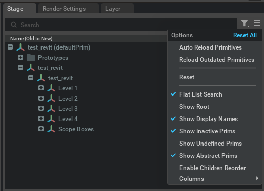

If you want to view your original names (before they were changed), you can do that in the Omniverse app by:
  1. Locate the “Stage” tab (right-hand side of window).
  2. Left-click on the “hamburger” menu.
  3. Select Show Display Names.
This will show the original names you’re used to seeing, instead of the transcoded ones.
