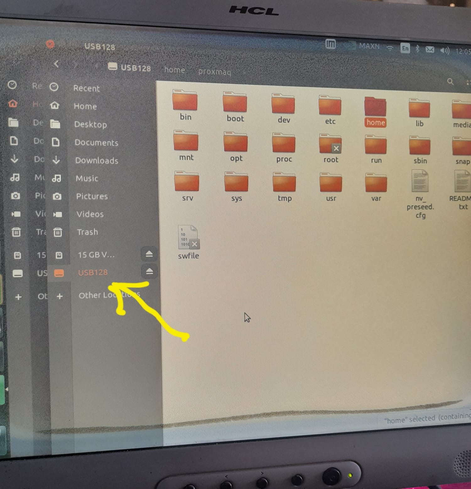

Hi, I have another bootable pendrive through which I can log in to jetson and I can access my non-bootable pendrive(pointed by the yellow arrow) as a storage device. So does it work if I change any root files or any other files in a non-bootable pendrive?
Are you talking about you can boot from this pendrive on another Jetson and you want to put this pendrive to the one that hits problem now?
Sorry for the confusion i caused. I have only one jetson nano but 2 bootable pendrives, 1 is 30GB and the other one is 128 GB. Now I had booting problem with 120GB pendrive. I logged in my jetson using 30GB old bootable pendrive and accessed 120 GB pendrive as an external storage device as you have seen in the image.
now, my question is, does my 128 GB pendrive work if i change any root files or any trouble-caused files in it?

And, I’m not able to log in into board to run command df -h. I’m able to login from serial console from my ubuntu laptop.
I don’t understand what does that mean … do you realize that your serial console is the terminal for your Jetson?..
And also the result of lsmod
Yeah i entered wrong command and got command not found
here is df -h
Filesystem      Size  Used Avail Use% Mounted on
/dev/sda1       113G   66G   41G  62% /
none            1.8G     0  1.8G   0% /dev
tmpfs           2.0G     0  2.0G   0% /dev/shm
tmpfs           2.0G  102M  1.9G   6% /run
tmpfs           5.0M  4.0K  5.0M   1% /run/lock
tmpfs           2.0G     0  2.0G   0% /sys/fs/cgroup
/dev/loop0       50M   50M     0 100% /snap/core18/2800
/dev/loop2       36M   36M     0 100% /snap/snapd/20674
/dev/loop1       36M   36M     0 100% /snap/snapd/20298
/dev/loop3       50M   50M     0 100% /snap/core18/2810
/dev/loop4      128K  128K     0 100% /snap/kesty-whatsapp/33
tmpfs           397M     0  397M   0% /run/user/1000
lsmod
Module                  Size  Used by
The issue here is your lsmod is empty. nvgpu driver is gone so graphic won’t show.
Please share the result of uname -r and ls /lib/modules result.
Got it.
uname -r
4.9.253-tegra
ls /lib/modules
4.9.337-tegra
