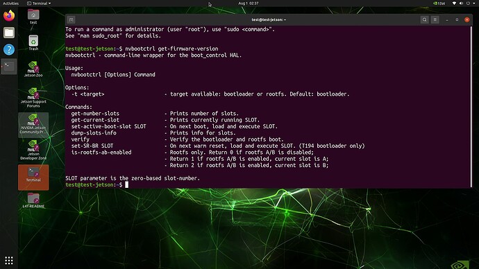

Even this command isn’t valid. no such option called get-firmware-version. An AI hallucination :)?

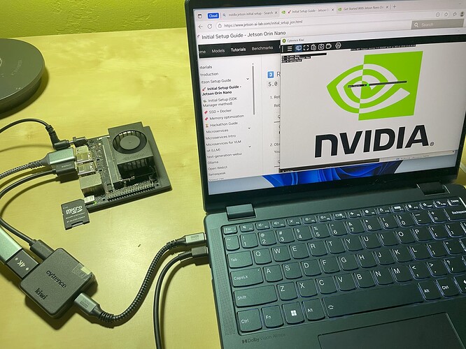

P.S.: during this troubleshooting process, I used Cytrence Kiwi (the small black gadget in the photos below) which really helped to observe the subtle changes with its video recording feature. It was also very convenient to access Jetson’s GUI without extra monitor, keyboard/mouse - all I needed was just my laptop. I could even copy&paste commands to Jetson without network. Happy to share my setup:
