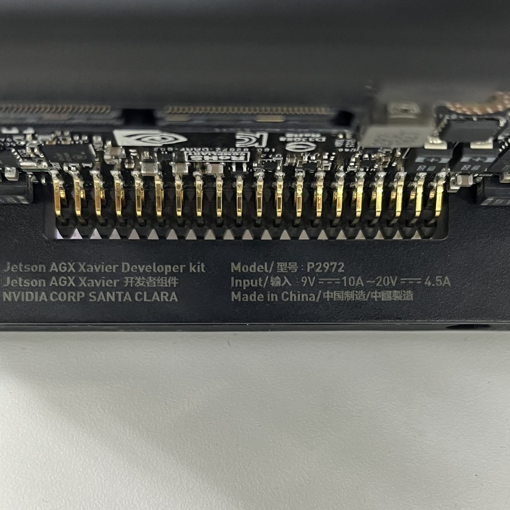

Can you please share the part number of module which should contain numbers of “2888” and printed or labeled on board?
Also, can you do one more test that remove backup battery and turn off with adapter attached and then turn on. Let’s check if time can be kept in such case.
is this what you are talking about?
P2972
No, part number of module which contain “2888”.
I don’t see it! There is S/N but it does not contain 2888. How to find it? I have the device with me!
Can you do one more test that remove backup battery and turn off with adapter attached and then turn on. Let’s check if time can be kept in such case.
Like the photo here: NVIDIA Jetson AGX XAVIER development board module core board P2888 | eBay
It is resetting to the 2000-01-01
I am sorry but I have other model. An example is shown here
