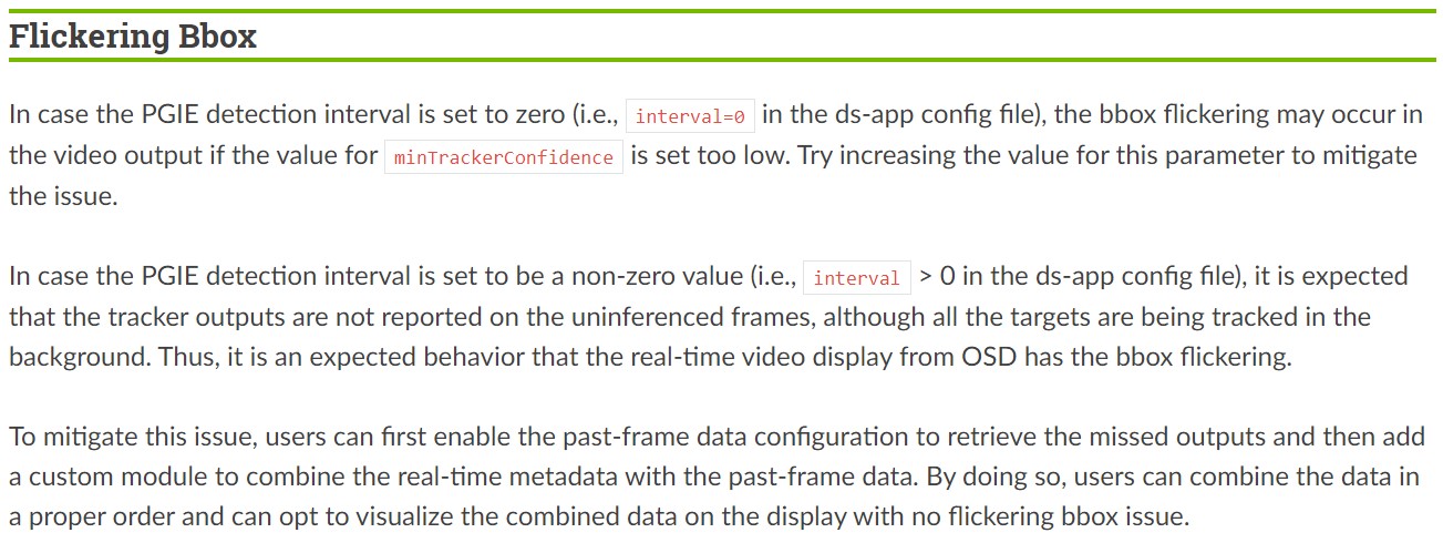

Hello, I’m working on solution based on DeepStream which will anonimize objects on video. I use YoloV4 as a detector and NvDCF tracker to sustain bounding boxes from detector. The problem is when detector doesn’t return box i.e. for one frame (false negative) the tracker also doesn’t return box (shadow tracking). It’s really important in anonimization task to get continuous anonimization without flickering box. I know there is something like past-frame data in tracker metadata but I get information about missing box too late, i.e. in 6th frame I get information that in 5th and 4th frames something was tracked in shadow mode but this frames I pushed downstream before. I was looking in documentation and I found that you suggest to add custom module.
Can you tell me how I should prepare this module? Maybe there is some template for that?

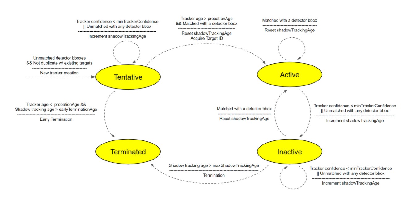

Can you have a try to increase maxShadowTrackingAge?
Gst-nvtracker — DeepStream 6.0 Release documentation (nvidia.com)
But how it can help me? The object will be tracked longer in shadow mode but what it will give me? My point is to get bbox from shadow mode and modify frame with this box but from past-frame data I get information about that boxes too late. If I will get information in 8th frame that in 6th and 7th frames there was a box tracked in shadow mode I need to return to this frames to modify them but how? If I will increase maxShadowTrackingAge I will have to make bigger delay and thats it. And my question is how make this delay to push i.e. 6th frame downstream when I’m able to read past-data for 10th frame (maxShadowTrackingAge = 4).

Can you also have a try with maxShadowTrackingAge=0 and earlyTerminationAge=0? This setting will disable shadow tracking and then output BBox.
But I want to sustain bbox when detector return false negatvie for one or two frames and based on your documentation when there is not matched box from detector and also I set maxShadowTrackingAge=0 the tracked box will be terminated. It is active only when tracked box matched detected box.
But yes, I try maxShadowTrackingAge=0 and earlyTerminationAge=0 and it makes no difference. Based on your documentation using past-frame data is the only way to sustain bbox, so I still wait for a tips how should I do that.
