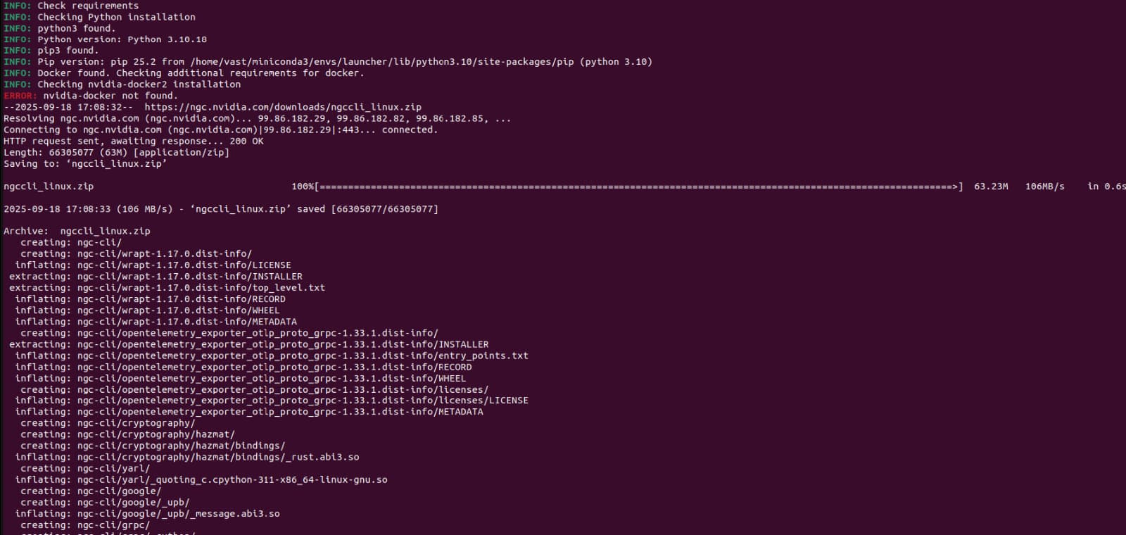

Note: Whenever I run the setup/quick_launcher.sh, it always installs tao 6.x even if I git checkout tao 5.x release. As tao 6.x doesn’t support yolo models for training, I need tao 5.x or lower. I also tried using wget command that downloads tao 5.x zip file and running the .sh file from there, still it installed tao 6.x.
Eventhough I got tao 5.x using pip install mentioned later in the post, the following shows an nvidia-docker not found error while running the setup/quick_launcher.sh script which installed tao 6.x as shown below:
But I had nvidia-docker2, nvidia-container-toolkit, and nvidia-container-runtime installed using apt.

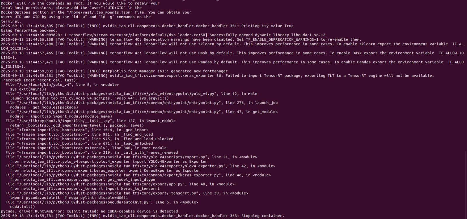

But, when I run,
tao model yolo_v4 –help, it says the following:
I have seen some other forum posts of similar problem. In the solutions you provided there, I have come across dpkg -l | grep cuda, and also nvidia-fabric-manager.
Why is cuda not mentioned in the documentation of tao toolkit? Just asking.
I installed cuda using sudo apt install nvidia-cuda-toolkit and rebooted the system, but, the still the issue persisted.
Also, in the cuInit error message above, why is python 3.8 mentioned, it is inside the docker, right? Because, I am on ubuntu22 with python3.10.
Can you please help with the cuInit error?
Could you debug with the hint mentioned in No CUDA-capable device is detected - #8 by Morganh ? Thanks.
Thank you very much Morganh :)
This link to this post in your above answer solved the issue for me.
