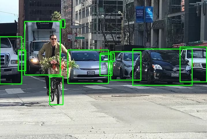

I’m trying to speed up my YOLO inference on a Jetson Orin Nano by converting an ONNX model to a TensorRT engine, but the detection outputs don’t match. The parser of onnx to engine is ok and i don’t have any error.

Thanks for the suggestions, but I think there’s still some confusion around how I’ve been testing:
ONNX + OpenCV (C++):
Pad → blobFromImage → forward → reshape+transpose → decode → NMS → draw
Uses exactly the same input.jpg and C++ code from my first post
Works: correct boxes
TensorRT + C++:
Serialize ONNX → load engine in C++ → same pad/blob/decode/NMS code → draw
Fails: draws one giant box or nonsense coordinates

Result: JSON dump of output tensors contains infinities and garbage box coords
What I’m really asking:
  • Why does the same model + same preprocessing + same post‑processing give correct detections in OpenCV+ONNX but broken ones in TensorRT?
  • Could it be the ONNX→TRT conversion, or a bug in the Detection/NMS plugin?
Any pointers on debugging the engine itself would be hugely appreciated!
