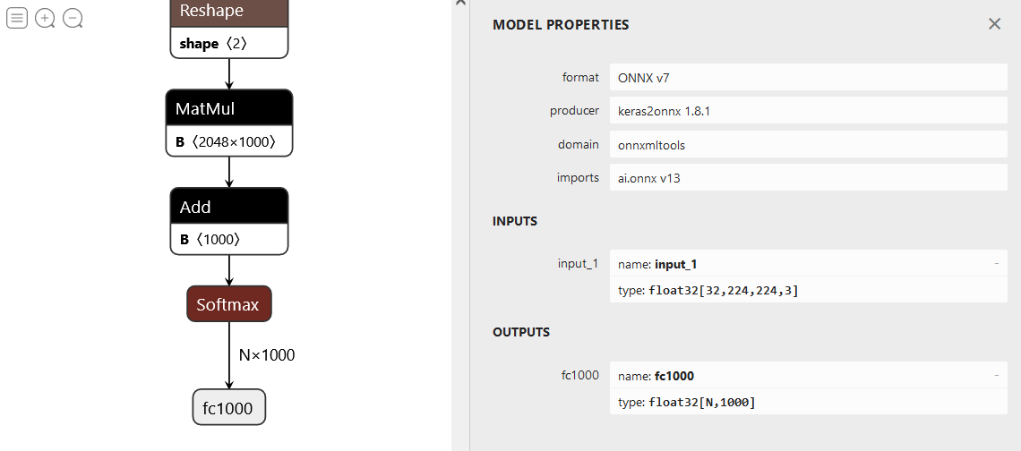

Is your model working with ONNX runtime?
Based on the error, it seems that it doesn’t have an output layer.
You can visualize it with the below website:
https://netron.app/
More, it’s still recommended to upgrade to the latest TensorRT version.

  2. I have visualized it. Indeed, with my model there seems to be something wrong, I will look into it. The ResNet50 model however, looks good to me. Inputs and outputs are being recognized.
As I am am follwing the instructions from the quick start guide, I would assume that at least the model and the conversion to onnx should have been done correctly.
