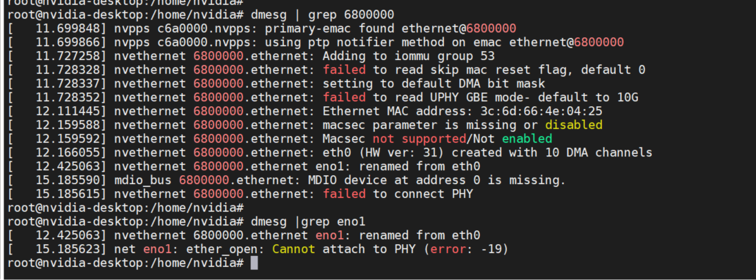

The 10-gigabit Ethernet port cannot be used normally. AQR113C
hi,
We designed our own motherboard, which has the exact same design for the 10-gigabit network interface as the official one.
The software version is using Jetpack 6.2. The configuration has not been modified; it is the official default configuration.
After the system starts up, the following error message appears:
Could you please help me analyze where the problem lies? Thank you very much.

Regarding the information you mentioned above, I’m not sure how to specifically check it. How do I view the firmware version of the PHY?
Did you contact the vendor and ask for the firmware of AQR113C?
Yes, I have already programmed the firmware.
please use MDIO tool to check the status of PHY . This sounds a hardware issue to me.
Report the following error
please review the hardware as below checklist is not able to be done.
  • Make sure that the PHY comes out of reset and is in a ready state (read the PHY ID by using mdio tool to ensure that the PHY firmware is successfully loaded) when the PHY reset GPIO is toggled.
