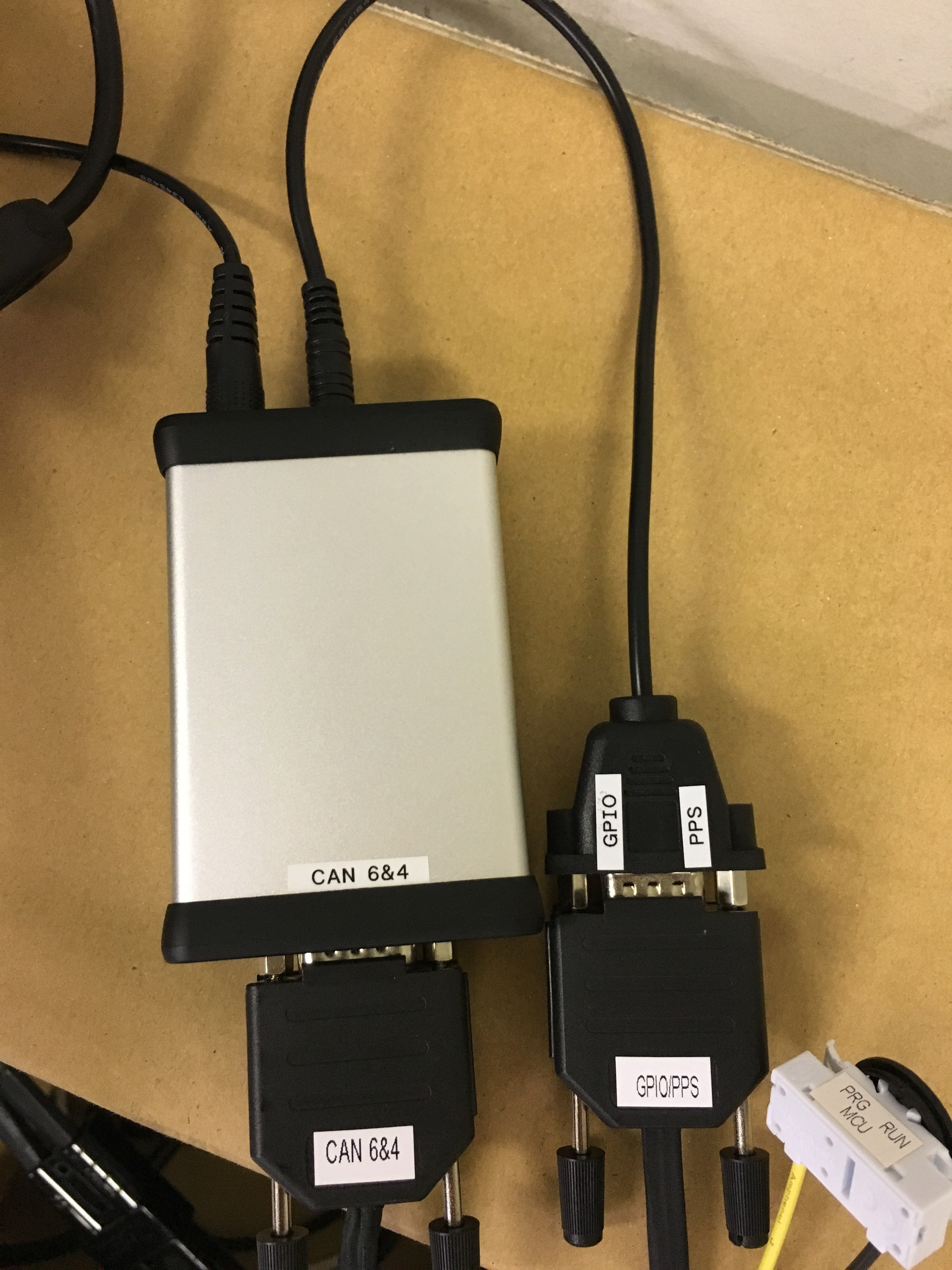

I have not connected to network/rtc dongle

I just make sure if you have a RTC Module or not and internet connection.
If you have a RTC module and internet connection, please follow the steps below.
Connecting the RTC Module
Before getting or setting the RTC module correct time, plug the module into cable harness connector labelled CAN_6_4. For details on the cable harness connections consult Setting Up Your E3550 Platform, Cable Harness topic. -

I removed and reconnected the RTC module.

Could you let me know why you removed and reconnected the RTC module?
Is this any test case for your project? Thanks.
This is because I thought there might be a connection failure in the RTC module.
