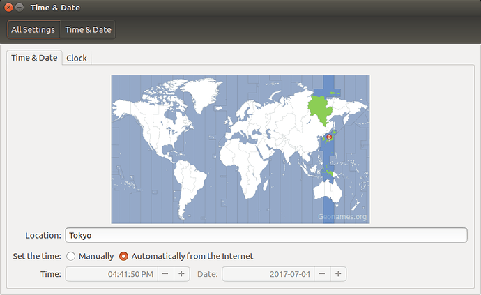

I wonder you have internet access and set the time correctly without the RTC dongle like below.
Did you set the time “Automatically from the Internet” in Time & Date like below capture?Image
External Media
Then you can check time with date command on the terminal.

First, I removed RTC dongle and set it like an image.
Then I tried the following command.
nvidia@tegra-ubuntu:~$ date
Tue Jul  4 16:39:24 JST 2017
nvidia@tegra-ubuntu:~$ sudo bash /etc/systemd/scripts/nv_rtc_sync.sh
try_ntp 4 Jul 16:39:37 ntpdate[3585]: no server suitable for synchronization found
getting rtccould not get time from dongle
Could not get time from RTC dongle
Tue Jul  4 16:39:51 JST 2017
reboot
The date command was still in 2017
The result does not change.

Then set the time “Automatically from the Internet” in Time & Date like below capture.
External Media
If you run the command without the RTC dongle, an error occurs. The message is expected.
Could you please upload your full step and log on the topic? Thanks.
