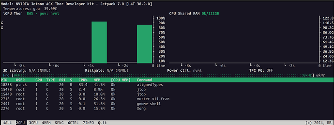

Thor with Jetpack 7.0, 3 questions about GPU:
  1. run Jetson Power GUI, there isn’t “Load percent“ about GPU. (maybe jtop doesn’t support thor already. but what about Jetson Power GUI?)
  2. run “ollama run deepseek-r1:8b“, 14 CPUs runs in 100%, but can’t get GPU usage. from Ollama - NVIDIA Jetson AI Lab
  3. $lsmod | grep nvgpu. (output nothing, no driver for gpu?)

Note that the Jetson AI Lab tutorial does not include the --runtime nvidia option in the example command. In our tests, adding this parameter was necessary for the Thor GPU to be recognized correctly.
As shown in the attached screenshot, during execution the GPU utilization reached 97%, confirming that the Thor GPU was fully engaged. The monitoring interface in the image is from Cordatus.

Added nvml and jetpack 7 support to jetson_stats and opened a pull request, though the project looks fairly abandoned at this point so not sure if it will get integrated.
