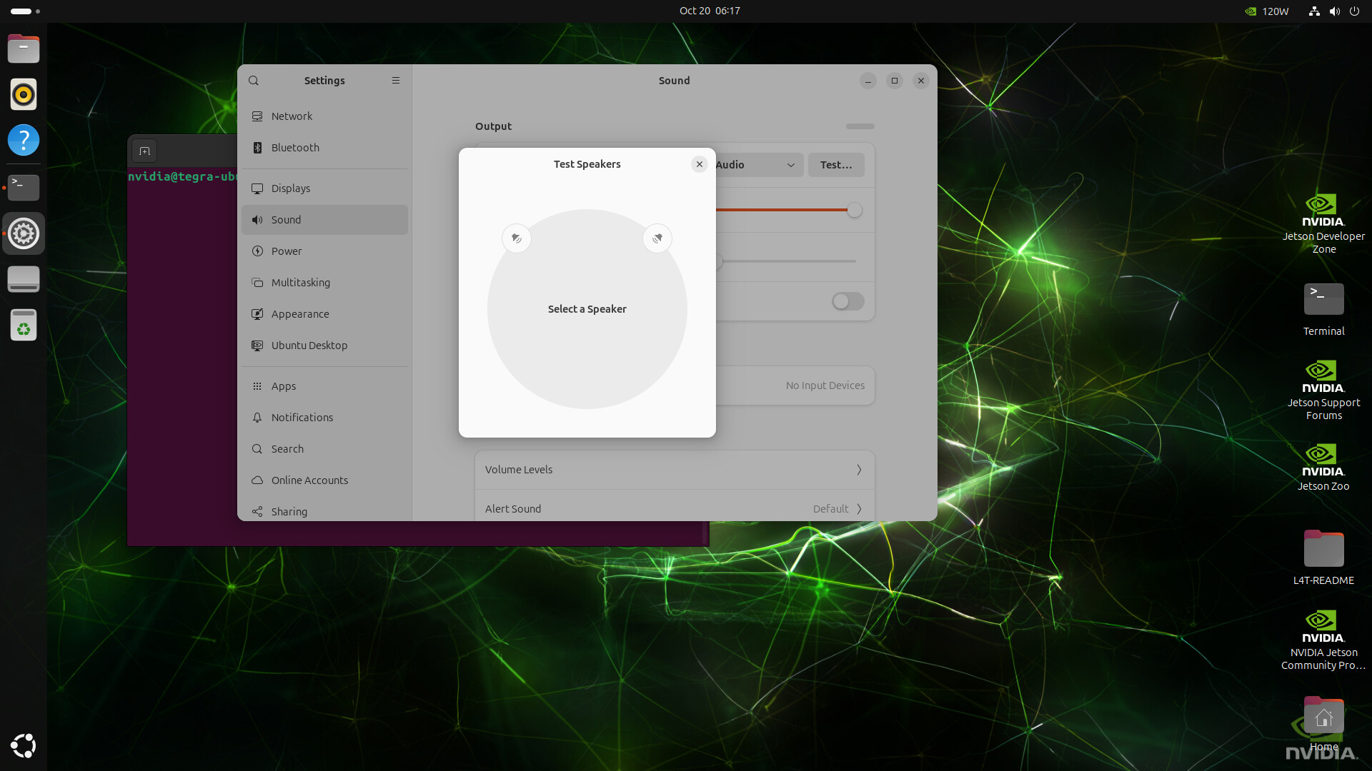

The testing method is to use the voice test function in the settings interface.

The command test can both collect and play, but in fact there is no sound output.

Using the sample audio files in here, there is no sound either.

yes
yes
Capable of detecting the signal reaching the pins of the codec chip.
Yesterday during the test, I was able to play audio. Since this was my first time testing the audio codec chip.
