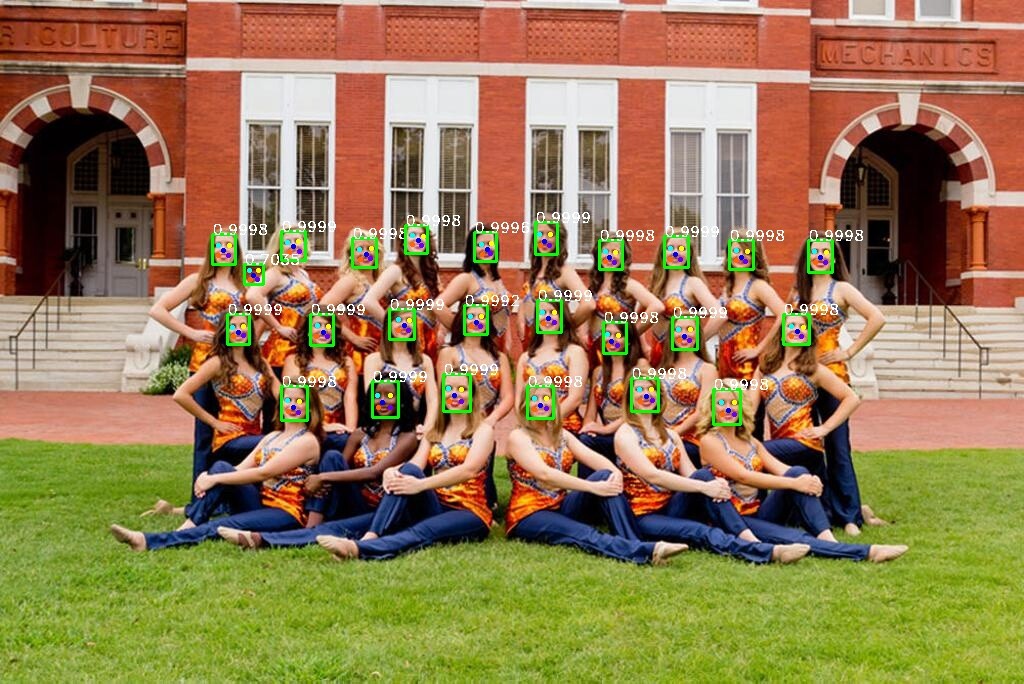

Many thanks, That solved the configuration problem. But i’m facing a new problem now and I’m not sure if it’s model related or is the problem with triton tensorflow backend.
The model is expected to output [-1, 16] tensor. The -1 is a dynamic value that is determined based on the number of objects detected.
As an example, this photo below:
This image outputs a tensor of size [25, 16] meaning the model detected 25 faces.
However, when using Triton, for some reason the model always outputs only 1 detection [1, 16]

  1. did you succeed to run your model by other inference tool? please make sure your model can work.
  2. do you mean inference will output one face before postprocessing? if yes, you need to check the data that feed to model, for example: compare the model input data between your code and other inference tool.
  1. Yes, inference using tensorflow is provided above (image and tensor output size)
  2. The input image, pre-processing and everything is exactly the same.
Can you maybe try to reproduce? I’ve provided the model and the scripts above.
Any further update? Is this still an issue to support? Thanks
using the sample code with yours, from the tritonserver log, there was only one detection, please check the model input data.
I0903 10:08:28.037014 19002 infer_response.cc:166] add response output: output: tf_op_layer_GatherV2, type: FP32, shape: [1,16].
