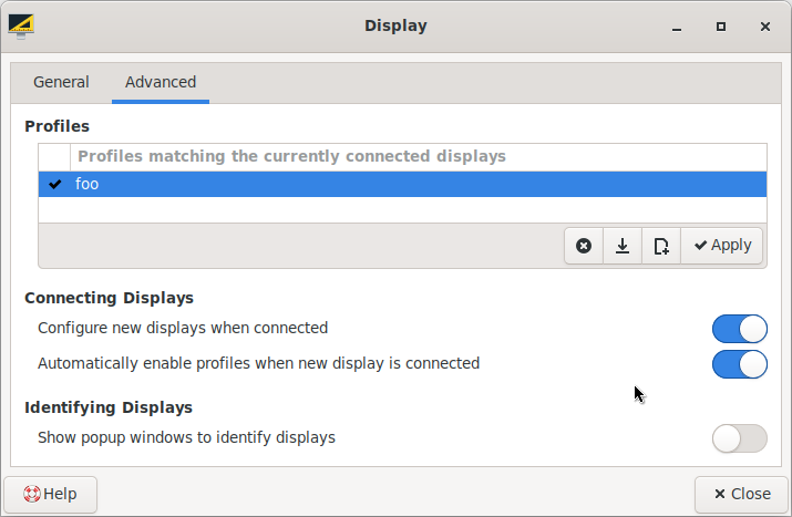

For the part about the resolution reverting after power save mode: it’s possible that your monitor is generating a hotplug event after powersave mode, which could be triggering your desktop environment to ask the driver to change the mode to the one it thinks is correct. If possible, can you please try changing the mode through your desktop environment’s control panel instead of nvidia-settings?
I tried reproducing this with fluxbox on a second Xorg display, I couldn’t reproduce the resolution reverting on resume from powersave, so I agree that XFCE is likely to blame for the reset on resume. I managed beating XFCE into submission by forcing it to apply a display settings profile every time it detects a new display.
Find screenshots of the display settings attached.
