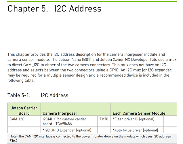

Hello in original schematic Jetson Orin Nx Carrier board you have TS3USB30E for CAM_I2C_SCL Switching. In case 4 MIPI-CSI camera could it be replaced with PCA9846PWJ?
Please refer to Jetson Nano, Jetson Nano 2GB, Jetson TX2 NX, and Jetson Xavier NX Camera Module Hardware Design Guide
PCA9846PWJ could be used as you have suggested.
