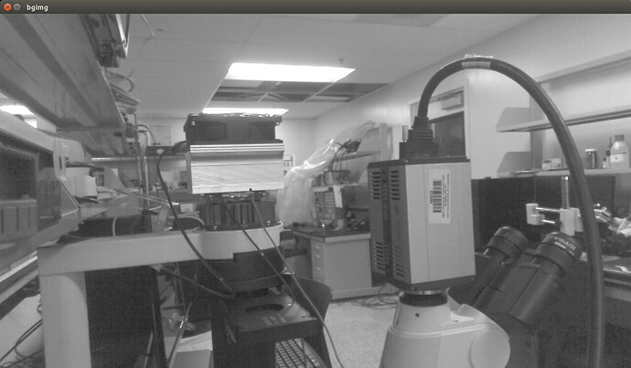

Also how can I access photo mode. I am running all this on c++ and OpenCV btw
For some reason the same line of code is giving me two different images
Also I essentially want a really dark image. Can u help me with the same please?
