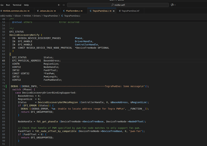

感谢您的回复帮助。我尝试过在TegraPwmDxe.c文件中添加打印信息来验证是否工作,发现添加的打印信息并没有输出。
我的操作步骤:
1.编译./edk2-nvidia/Platform/NVIDIA/Jetson/build.sh
2.cp ./images/uefi_Jetson_RELEASE.bin /home/ys/nvidia/35.3/Linux_for_Tegra/bootloader/uefi_jetson.bin
3.重启。
请问这个对应的是那个PWM?如果我更换其他的PWM我需要如何修改?
很奇怪,我修改UEFI源码,将TegraPwmDxe.c添加了debug信息,开机时debug并没有输出。

Could you use DEBUG_ERROR instead of DEBUG_INFO to print the log?
How did you clone the UEFI source? Could you share the command you run?
Please use uefi_Jetson_DEBUG.bin instead of uefi_Jetson_RELEASE.bin to print more debug messages.
PWM is specified in the device tree and fdt_* function will load it.

You just need to check the fdt related functions called in TegraPwmDxe.c.
I’m not clear about how did you customize the device tree and the debug messages in TegraPwmDxe.c.
Could you just refer to this TegraPwmDxe.c driver and the pwm-fan node in device tree to know how we enabled it? Then you can add another PWM for your use case for the LED.
