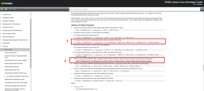

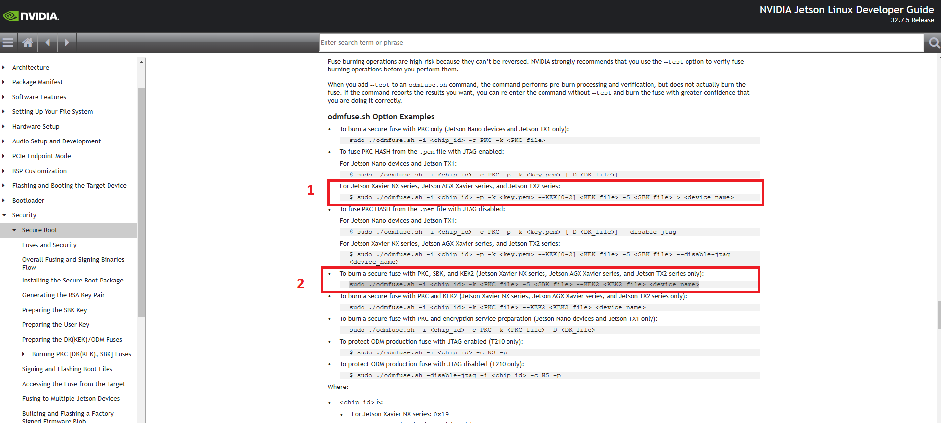

Hi Hi JerryChang,
Please check attached snippet and took it from link: https://docs.nvidia.com/jetson/archives/l4t-archived/l4t-3275/index.html#page/Tegra%20Linux%20Driver%20Package%20Development%20Guide/bootloader_secure_boot.html#
Please check highlighted part. Is any one of the option will be sufficient to burn a secure fuse. As I am using the 2nd option. I am able to burn the secure fuses and flash the image. But my Jetson AGX Xavier board is not booting and there is no prints on serial debug port.
I am not understanding the issue. Could you please provide your solution on this issue.
Waiting for your detailed information on this issue.
hello sagarkoli159,
please refer to Topic 117585 to fuse AGX Xavier.
as you can see, we’ve burning all the fuses, including production mode.
