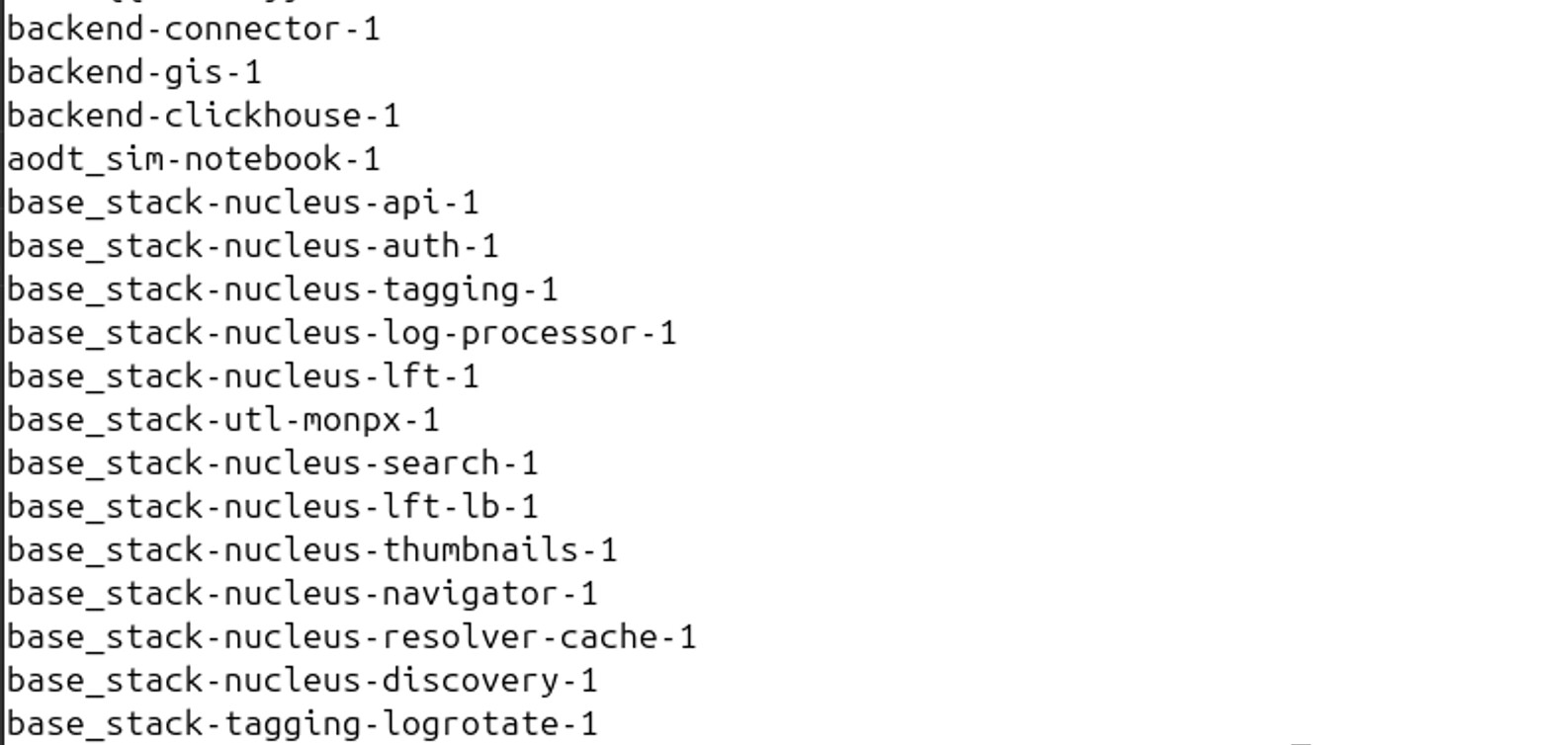

List of Containers running:
Could you please help me with this.

  1. Can you please share the output of nvidia-smi
  2. Can you please share the snapshot of configuration tab? (you can black out any IP address if you wish)
Can you share the bottom half of configuration? We want to ensure the correct assets paths
Thanks. That looks OK.
Did you update from 1.1? If so, how?

I installed aodt-1.2.0 from scratch by deleting all the files inside .local/share/ov/pkg/.
I removed all the containers after stopping them, and then I started the installation of aodt-1.2.0.
I also removed all the files of aodt-1.1.1
I followed the above steps of removing .live files of kyoto and restarted the backend, but still not able to connect to worker
If there is something wrong in these steps please do let me know.

yes, thats what we think. The asset files could be mixed up with previous version. Do you see anything under omniverse://<ip_address>/Library/ folder in the content tab?
This is the image of assets folder.
Are you able to resolve? There is a mix up of 1.1 assets and 1.2 assets.
If not, copy the content of Library/aodt_1.2.0 into Users/aerial.
This step resulted in the loss of worker.
@sxn0581 Please restart the container

@sxn0581 Please check the following:
  1. In the file /etc/hosts, omniverse-server is mapped to the correct ip address.
  2. In the file /opt/ove/base_stack/nucleus-stack.env, check if SERVER_IP_OR_HOST is set correctly.
  3. Please share the backend console output when you try to make a connection to the worker
