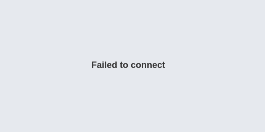

Also I have tried Ubuntu 18.04.5 desktop and server version in EFI Boot option, the VM is not booting up when using EFI option it shows failed to connect
VM_EFI_BOOT
