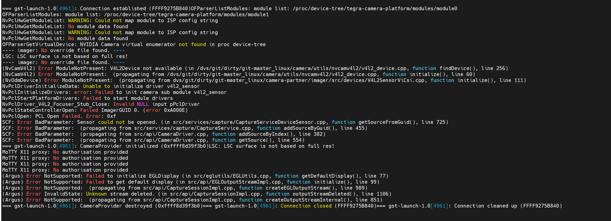

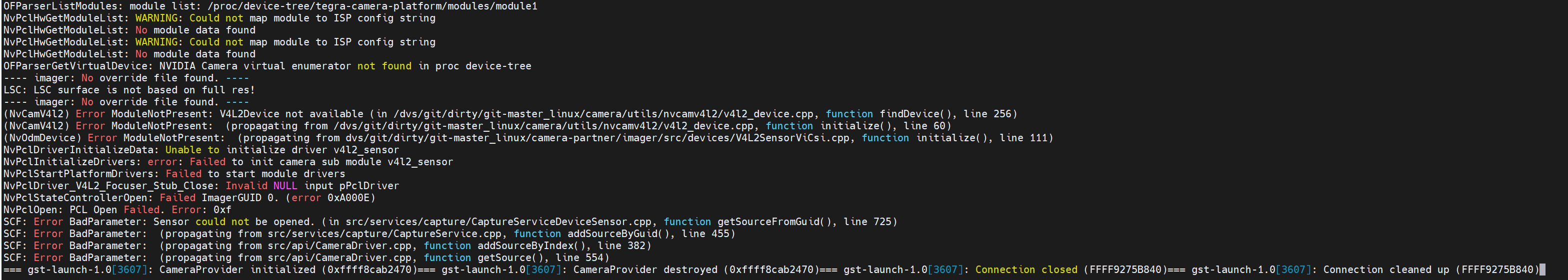

When I enter the following real-time preview commands, the displayed screens are all black. And accompanied by these log information
gst-launch-1.0 nvarguscamerasrc sensor-id=0 ! nvvidconv ! nv3dsink
Pipeline is live and does not need PREROLL ...
Pipeline is PREROLLED ...
New clock: GstSystemClock
GST_ARGUS: Creating output stream
CONSUMER: Waiting until producer is connected...
GST_ARGUS: Available Sensor modes :
GST_ARGUS: 3864 x 2192 FR = 16.000000 fps Duration = 62500000 ; Analog Gain range min 1.000000, max 10.625000; Exposure Range min 13000, max 683709000;
ARGUS_ERROR: Error generated. /dvs/git/dirty/git-master_linux/multimedia/nvgstreamer/gst-nvarguscamera/gstnvarguscamerasrc.cpp, execute: 946 Frame Rate specified is greater than supported
GST_ARGUS: Running with following settings:
Camera index = 0
Camera mode = 0
Output Stream W = 3864 H = 2192
seconds to Run = 0
Frame Rate = 16.000000
GST_ARGUS: Setup Complete, Starting captures for 0 seconds
GST_ARGUS: Starting repeat capture requests.
CONSUMER: Producer has connected; continuing.
ARGUS_ERROR: Error generated. /dvs/git/dirty/git-master_linux/multimedia/nvgstreamer/gst-nvarguscamera/gstnvarguscamerasrc.cpp, execute: 1208 InvalidState.
GST_ARGUS: Cleaning up
ERROR: from element /GstPipeline:pipeline0/GstNvArgusCameraSrc:nvarguscamerasrc0: Internal data stream error.
Additional debug info:
../libs/gst/base/gstbasesrc.c(3127): gst_base_src_loop (): /GstPipeline:pipeline0/GstNvArgusCameraSrc:nvarguscamerasrc0:
streaming stopped, reason error (-5)
Execution ended after 0:00:01.018388005
Setting pipeline to NULL ...
nvbuf_utils: dmabuf_fd -1 mapped entry NOT found
Error generated. /dvs/git/dirty/git-master_linux/multimedia/nvgstreamer/gst-nvarguscamera/gstnvarguscamerasrc.cpp, threadExecute:734 NvBufSurfaceFromFd Failed.
Error generated. /dvs/git/dirty/git-master_linux/multimedia/nvgstreamer/gst-nvarguscamera/gstnvarguscamerasrc.cpp, threadFunction:245 (propagating)
Freeing pipeline ...
st-launch-1.0 nvarguscamerasrc sensor-id=0 ! 'video/x-raw(memory:NVMM),width=3864,height=2192,format=NV12,framerate=15/1' ! nvvidconv ! nv3dsink

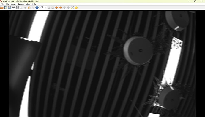

However, when using frame data capture, the data can be obtained normally.And it can also save pictures in raw format, which open normally.
root@pcai-desktop:/home/pcai/pkg_orin_nx_jp6.1_v7.4.1# v4l2-ctl -d /dev/video0 -V --set-ctrl bypass_mode=0 --stream-mmap
Format Video Capture:
Width/Height : 3864/2192
Pixel Format : 'GB12' (12-bit Bayer GBGB/RGRG)
Field : None
Bytes per Line : 7728
Size Image : 16939776
Colorspace : sRGB
Transfer Function : Default (maps to sRGB)
YCbCr/HSV Encoding: Default (maps to ITU-R 601)
Quantization : Default (maps to Full Range)
Flags :
<<<<<<<<<<<<<<<<< 15.00 fps
This is the LOG information captured when the screen is black.
dmesg.txt (66.3 KB)
trace.txt (21.7 KB)

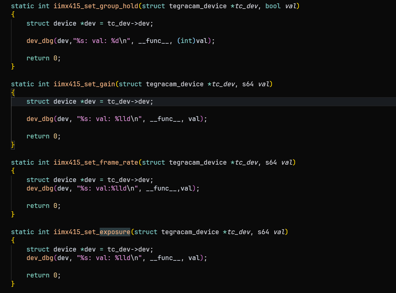

source file:
imx415.c.txt (17.9 KB)
imx415-dtsi.txt (11.8 KB)
imx415-overlay.txt (2.9 KB)
