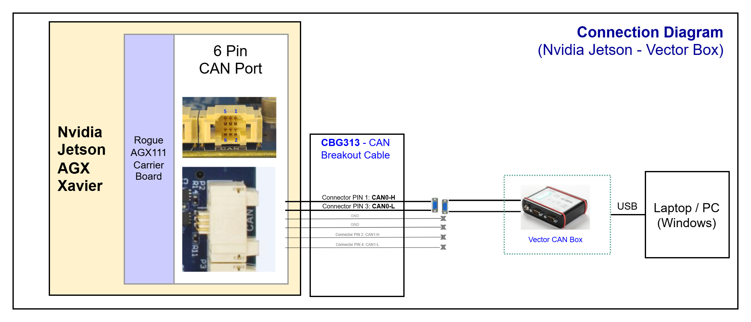

I would also like to know the block diagram of your connection how do you verify this. (can0 to can1?)
You can also provide the following information for your CAN configurations.
$ sudo ip -d -s link show can0
Hi KevinFFF,
admin@platform12:/home/platform$ cat /etc/nv_tegra_release
# R32 (release), REVISION: 6.1, GCID: 27863751, BOARD: t186ref, EABI: aarch64, DATE: Mon Jul 26 19:36:31 UTC 2021
I am sending CAN data from a different controller but for development using Vector CAN box. Also, I was using a different CAN configuration (0.5 kbps nominal bitrate and 2 mbps data bitrate) previously, and it is working fine.
I can share the below block diagram for now.
As for verification, I am able to receive the CAN signals with this configuration. (candump can0)

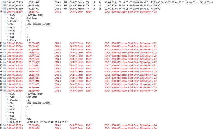

If I try to send the CAN messages using cansend command, I am getting the following error in the Vector SW.
admin@platform12:~$ candump can0
  can0  567  [64]  10 89 31 01 FF 00 85 FF 43 04 4D 53 54 52 03 00 00 00 37 00 00 00 52 11 F0 FA 41 CF 90 E5 00 1B 0D 00 01 00 00 00 00 00 51 35 80 00 00 00 FB DF AC 2B 2C 0D 66 37 50 BC 01 00 00 00 00 00 00 00
  can0  567  [16]  00 0C 31 01 FF 00 08 FF 2A 04 10 01 01 0D 00 00
  can0  567  [16]  00 0C 31 01 FF 00 08 FF 2A 04 10 01 02 0D 00 00
^C
admin@platform12:~$
admin@platform12:~$ cansend can0 567##1000C3101FF0008FF2A041001020D
admin@platform12:~$
admin@platform12:~$ dmesg | grep can

[  136.272273] mttcan c310000.mttcan can0: Bitrate set
[  136.802569] mttcan_controller_config: ctrlmode 30
[  136.802615] mttcan c310000.mttcan can0: Bitrate set
[  136.802756] IPv6: ADDRCONF(NETDEV_UP): can0: link is not ready
[  136.802802] IPv6: ADDRCONF(NETDEV_CHANGE): can0: link becomes ready
[  152.568887] mttcan c310000.mttcan can0: Bit0 Error Detected
[  152.569111] mttcan c310000.mttcan can0: IR 0x10010000 PSR 0x50f
[  152.569271] mttcan c310000.mttcan can0: entered error warning state
[  152.569397] mttcan c310000.mttcan can0: Bit0 Error Detected
[  152.569516] mttcan c310000.mttcan can0: IR 0x11000000 PSR 0x55f
[  152.569659] mttcan c310000.mttcan can0: entered error passive state
[  152.569784] mttcan c310000.mttcan can0: Bit0 Error Detected
[  152.569895] mttcan c310000.mttcan can0: IR 0x10800000 PSR 0x57f
[  152.570024] mttcan c310000.mttcan can0: Bit0 Error Detected
[  152.570140] mttcan c310000.mttcan can0: IR 0x10000000 PSR 0x57f
[  152.570310] mttcan c310000.mttcan can0: entered bus off state
[  152.570424] mttcan c310000.mttcan can0: Bit0 Error Detected
[  152.570538] mttcan c310000.mttcan can0: IR 0x12000000 PSR 0x5e7
[  152.671331] mttcan c310000.mttcan can0: wait for bus off seq
[  152.683391] mttcan c310000.mttcan can0: entered error warning state
[  152.683546] mttcan c310000.mttcan can0: entered error passive state
[  152.683677] mttcan c310000.mttcan can0: entered bus off state
[  152.683830] mttcan c310000.mttcan can0: Bit0 Error Detected
[  152.683941] mttcan c310000.mttcan can0: IR 0x1b800000 PSR 0x5e5
[  152.684088] IPv6: ADDRCONF(NETDEV_CHANGE): can0: link becomes ready
[  152.787334] mttcan c310000.mttcan can0: wait for bus off seq
[  152.799390] mttcan c310000.mttcan can0: entered error warning state
[  152.799550] mttcan c310000.mttcan can0: entered error passive state
[  152.799683] mttcan c310000.mttcan can0: entered bus off state
[  152.799792] mttcan c310000.mttcan can0: Bit0 Error Detected
[  152.799901] mttcan c310000.mttcan can0: IR 0x1b800000 PSR 0x5e5
[  152.903338] mttcan c310000.mttcan can0: wait for bus off seq
[  152.915424] mttcan c310000.mttcan can0: entered error warning state
[  152.915603] mttcan c310000.mttcan can0: entered error passive state
[  152.915734] mttcan c310000.mttcan can0: entered bus off state
[  152.915845] mttcan c310000.mttcan can0: Bit0 Error Detected
[  152.916010] mttcan c310000.mttcan can0: IR 0x1b800000 PSR 0x5e5
[  153.019392] mttcan c310000.mttcan can0: wait for bus off seq
[  153.032423] mttcan c310000.mttcan can0: entered error warning state
[  153.032571] mttcan c310000.mttcan can0: entered error passive state
[  153.032733] mttcan c310000.mttcan can0: entered bus off state
[  153.032839] mttcan c310000.mttcan can0: Bit0 Error Detected

Do you mean that you can receive data from Vector CAN Box but cannot send data from mttcan?
Please share the exact command you run to send CAN FD data from mttcan.
It’s a quite old release, could you also verify with the latest r32.7.6 or r35.6.2 for AGX Xavier?
I am not able to verify with latest r35.6.2 Jetpack version.
Please try writing to c310000.mttcan if you are using can0 .
There is no file with name tdcr. I tried creating it, but it didn’t work.
Yes. with the configuration mentioned above, I can receive the CAN data. But there is problem while sending the data.
I am using the below command to send the CAN data.
Please configure tdc_offset instead as following.
# echo "0x600" > /sys/devices/c310000.mttcan/net/can0/tdc_offset
# echo "0x600" > /sys/devices/c320000.mttcan/net/can1/tdc_offset
Is there any error showing in dmesg when you run this command?
Hi Kevin,
I was able to configure as per the command shared.
But I am still not able to send the CAN message.
below is the dmesg logs when I run the cansend command.

[ 1577.059469] mttcan c310000.mttcan can0: Bit0 Error Detected
[ 1577.059680] mttcan_poll_ir: 21 callbacks suppressed
[ 1577.059800] mttcan c310000.mttcan can0: IR 0x10010000 PSR 0x51f
[ 1577.059982] mttcan c310000.mttcan can0: entered error warning state
[ 1577.060132] mttcan c310000.mttcan can0: entered error passive state
[ 1577.060250] mttcan c310000.mttcan can0: Bit0 Error Detected
[ 1577.060366] mttcan c310000.mttcan can0: IR 0x11800000 PSR 0x57f
[ 1577.060526] mttcan c310000.mttcan can0: Bit0 Error Detected
[ 1577.060643] mttcan c310000.mttcan can0: IR 0x10000000 PSR 0x57f
[ 1577.060801] mttcan c310000.mttcan can0: entered bus off state
[ 1577.060915] mttcan c310000.mttcan can0: Bit0 Error Detected
[ 1577.061028] mttcan c310000.mttcan can0: IR 0x12000000 PSR 0x5e7
and the bus goes off

Have you also checked the frequency of parent clock and try using another parent clock for 5Mbps?
This option should help you recovering from bus-off state, not sure why it does not help for your case.
