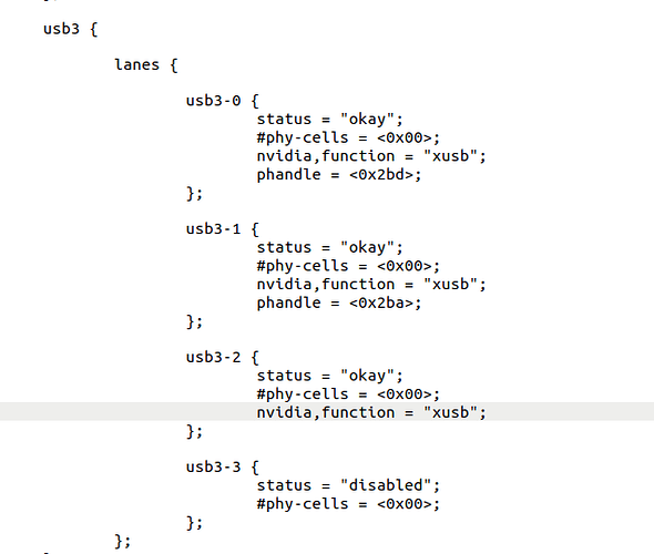

I used Jetpack6.0DP. I was going to enable Orin nano’s USBSS2, but after flashing to the board, the device tree did not update and USB3.0 did not work properly.
Modify the file directory is:
Linux_for_Tegra/source/hardware/nvidia/t23x/nv - public/tegra234 - p3768-0000. dtsi
tegra234-p3768-0000.txt (4.8 KB)
The generated file directory is:
boot/tegra234-p3768-0000+p3767-0000.dtb
tegra234-p3768-0000+p3767-0000.txt (163.9 KB)
The following two files are modification files, and the generated files are converted to dts files

I switched back to jetpack5. But the generated file usb3-2 does not have phandle.Is there any problem with this?
You should clarify how you generate your file out.
Hi,What I do with this part of the file is compile and transfer it to the destination folder.
./nvbuild.sh -o $PWD/kernel_out
and
sudo cp -rf kernel_out/arch/arm64/boot/dts/nvidia/* /home/microtnt/nvidia/Linux_for_Tegra/kernel/dtb/
So dose that phandle exist in the dtb under kernel_out or not?
Hi, as shown in my picture above, there is no phandle.
