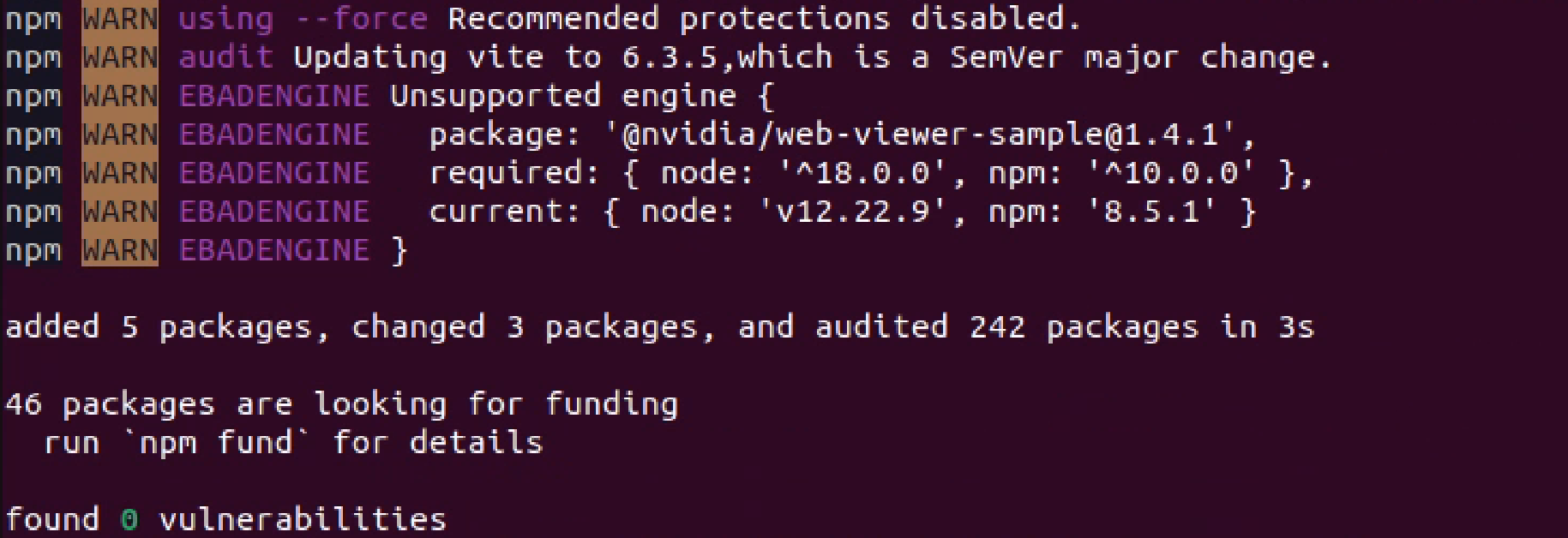

Hi @Richard3D I am getting few unsupported engine warnings, when doing npm install.
After doing “npm audit fix --force” … I got this.
And then same error after doing “npm run dev”
Hi @Richard3D I got it working after using node compatible version. Thanks a lot.
