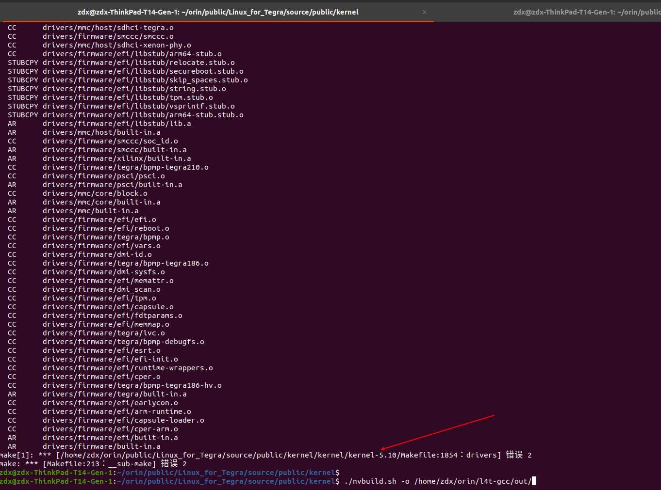

hello,all:
We are a self-developed board of JETSON AGX ORIN 32gb, with an ORIN module of P3701. When debugging the USB device, we found that USB0 connection is not working. Based on understanding, try modifying the device tree of the Linux kernel. Downloaded the latest version of Jetson Linux Source:
Decompression pubic_ sources.tbz2, locate the kernel_ Src.tbz2 Continue extracting files.
When compiling the kernel 5.10(kernel_ Src), an error occurred during compilation. How to resolve this issue?
report error log:
zdx@zdx-ThinkPad-T14-Gen-1:~/orin/public/Linux_for_Tegra/source/public/kernel$ ./nvbuild.sh -o /home/zdx/orin/l4t-gcc/out/

請問你們的cross compiler用的是哪一版?
export CROSS_COMPILE=~/orin/l4t-gcc/aarch64–glibc–stable-2022.08-1/bin/aarch64-buildroot-linux-gnu-
你可以把整個source code的目錄刪掉重來一次嗎?可能是你解壓縮的時候有些檔案漏掉
我很確定document上的步驟是沒問題的
我的步骤是下载kernel_src.tbz2:
tar xjf kernel_src.tbz2
sudo apt install build-essential bc
export CROSS_COMPILE_AARCH64_PATH=~/orin/l4t-gcc/aarch64–glibc–stable-2022.08-1/
export CROSS_COMPILE_AARCH64=~/orin/l4t-gcc/aarch64–glibc–stable-2022.08-1/bin/aarch64-buildroot-linux-gnu-
mkdir kernel_out
./nvbuild.sh -o ~/orin/sorce/kernel_out
我这边重新来了3次上述的步骤了,都是这样的报错。
你用錯版本了,請下載這一個
https://developer.nvidia.com/embedded/jetson-linux/bootlin-toolchain-gcc-93
