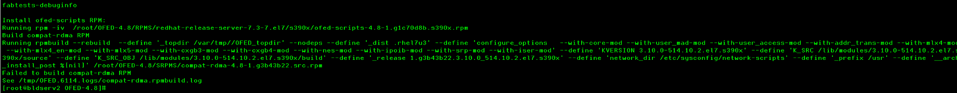

Recently, we are investigating a possibility of running the IPoIB/RDS protocol on the RoCE interface of IBM LinuxONE Server (which can running mainstream Enterprise Linux system, such as RHEL, SLES and UBUNTU).
It integrated a Mellanox MT27500 ConnectX-3 card as a 10GbE RoCE interface.
But i had found that the inbox driver with the redhat linux distribution seems to be incomplete, the most apparent evidence to support this are the “InfiniBand Support” and “infiniband-diags” subgroup are missing in the repository.
So, i turn to this forum for help.
Does anyone know the process to build the driver on a s390x arch system?
Any help are appreciate!
Regards
FuLong
Here is the reported issues in the compat-rdma.rpmbuild.log
CC [M] /var/tmp/OFED_topdir/BUILD/compat-rdma-4.8/drivers/net/ethernet/mellanox/mlx5/core/vport.o
CC [M] /var/tmp/OFED_topdir/BUILD/compat-rdma-4.8/drivers/net/ethernet/mellanox/mlx5/core/sriov.o
CC [M] /var/tmp/OFED_topdir/BUILD/compat-rdma-4.8/drivers/net/ethernet/mellanox/mlx5/core/fs_cmd.o
/var/tmp/OFED_topdir/BUILD/compat-rdma-4.8/drivers/net/ethernet/mellanox/mlx4/en_rx.c: In function 'mlx4_en_poll_rx_cq':
/var/tmp/OFED_topdir/BUILD/compat-rdma-4.8/drivers/net/ethernet/mellanox/mlx4/en_rx.c:1191:3: error: implicit declaration of function 'irq_desc_get_irq_data' [-Werror=implicit-function-declaration]
aff = irq_desc_get_irq_data(cq->irq_desc)->affinity;
/var/tmp/OFED_topdir/BUILD/compat-rdma-4.8/drivers/net/ethernet/mellanox/mlx4/en_rx.c:1191:44: error: invalid type argument of '->' (have 'int')
cc1: some warnings being treated as errors
make[3]: *** [/var/tmp/OFED_topdir/BUILD/compat-rdma-4.8/drivers/net/ethernet/mellanox/mlx4/en_rx.o] Error 1
make[2]: *** [/var/tmp/OFED_topdir/BUILD/compat-rdma-4.8/drivers/net/ethernet/mellanox/mlx4] Error 2
make[2]: *** Waiting for unfinished jobs....
CC [M] /var/tmp/OFED_topdir/BUILD/compat-rdma-4.8/drivers/net/ethernet/mellanox/mlx5/core/fs_core.o
CC [M] /var/tmp/OFED_topdir/BUILD/compat-rdma-4.8/drivers/net/ethernet/mellanox/mlx5/core/fs_counters.o
CC [M] /var/tmp/OFED_topdir/BUILD/compat-rdma-4.8/drivers/net/ethernet/mellanox/mlx5/core/rl.o
CC [M] /var/tmp/OFED_topdir/BUILD/compat-rdma-4.8/drivers/net/ethernet/mellanox/mlx5/core/wq.o
CC [M] /var/tmp/OFED_topdir/BUILD/compat-rdma-4.8/drivers/net/ethernet/mellanox/mlx5/core/en_main.o
CC [M] /var/tmp/OFED_topdir/BUILD/compat-rdma-4.8/drivers/net/ethernet/mellanox/mlx5/core/en_common.o
CC [M] /var/tmp/OFED_topdir/BUILD/compat-rdma-4.8/drivers/net/ethernet/mellanox/mlx5/core/en_fs.o
CC [M] /var/tmp/OFED_topdir/BUILD/compat-rdma-4.8/drivers/net/ethernet/mellanox/mlx5/core/en_ethtool.o
CC [M] /var/tmp/OFED_topdir/BUILD/compat-rdma-4.8/drivers/net/ethernet/mellanox/mlx5/core/en_tx.o
CC [M] /var/tmp/OFED_topdir/BUILD/compat-rdma-4.8/drivers/net/ethernet/mellanox/mlx5/core/en_rx.o
CC [M] /var/tmp/OFED_topdir/BUILD/compat-rdma-4.8/drivers/net/ethernet/mellanox/mlx5/core/en_rx_am.o
CC [M] /var/tmp/OFED_topdir/BUILD/compat-rdma-4.8/drivers/net/ethernet/mellanox/mlx5/core/en_txrx.o
CC [M] /var/tmp/OFED_topdir/BUILD/compat-rdma-4.8/drivers/net/ethernet/mellanox/mlx5/core/en_clock.o
CC [M] /var/tmp/OFED_topdir/BUILD/compat-rdma-4.8/drivers/net/ethernet/mellanox/mlx5/core/vxlan.o
CC [M] /var/tmp/OFED_topdir/BUILD/compat-rdma-4.8/drivers/net/ethernet/mellanox/mlx5/core/en_tc.o
CC [M] /var/tmp/OFED_topdir/BUILD/compat-rdma-4.8/drivers/net/ethernet/mellanox/mlx5/core/en_arfs.o
CC [M] /var/tmp/OFED_topdir/BUILD/compat-rdma-4.8/drivers/net/ethernet/mellanox/mlx5/core/en_fs_ethtool.o
CC [M] /var/tmp/OFED_topdir/BUILD/compat-rdma-4.8/drivers/net/ethernet/mellanox/mlx5/core/en_dcbnl.o
LD [M] /var/tmp/OFED_topdir/BUILD/compat-rdma-4.8/drivers/net/ethernet/mellanox/mlx5/core/mlx5_core.o
make[1]: *** [_module_/var/tmp/OFED_topdir/BUILD/compat-rdma-4.8] Error 2
make[1]: Leaving directory `/usr/src/kernels/3.10.0-514.10.2.el7.s390x'
make: *** [kernel] Error 2
error: Bad exit status from /var/tmp/rpm-tmp.UO3eLF (%build)
RPM build errors:
user vlad does not exist - using root
Regards
FuLong
