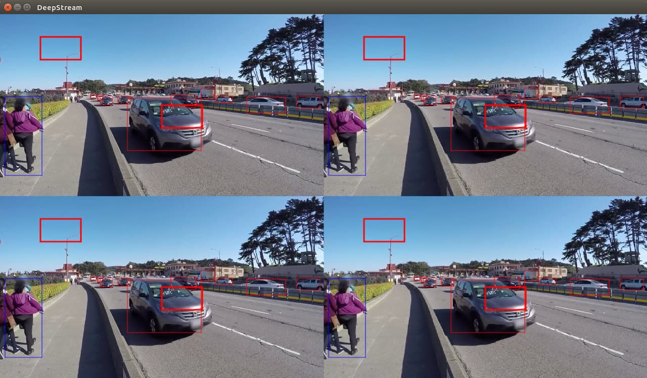

i would like to ask a question about dsexample, when i enable it and run test5, two bbox shows but the resize didn’t work, what’s this problem? should i add dsexample in create common pipline?

Do you mind sharing more about the problem you are facing currently?
The patch you shared above is trying to get the GPU property.
Do you want the information?
For the resize issue, do you use our default bounding box parser?
Or a customized implementation?

1\the first dsexample, when i enable=1 it shows that 2 fake boxes on menu only, and no pictures to save i used default bounding box parser, but my model is custom yolo4, how should i do? i also checked fourms for more informations, should i have to modify out CV MAT in convert-mat funtions to get dsexample to work ?
