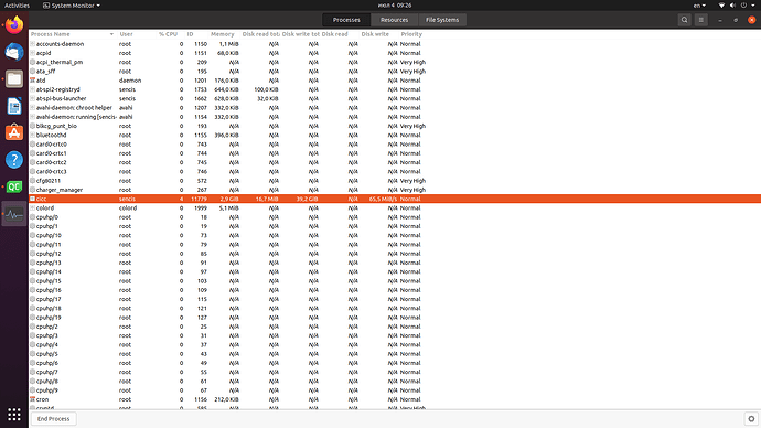

Why nested 3D data structures cause a crash cuda?
I use a simple organization of 3D data structures to create a grid on CPU and fast searching occupied cells.
struct Voxel
  uint8_t ID = 0;
  uint8_t hit_counter = 0;
struct Chunk_level_1
  uint8_t counter = 0;
  Voxel voxel [10][10][10] = {0}; // 1 000
struct Chunk_level_2
  Chunk_level_1 Chk_Lv1 [10][10][10]= {0};  // 1 000 000
Chunk_level_2 Chk_Lv2 [10][10][10] = {0};  //1 000 000 000
I want to declare it as a global variable to store in the gpu memory of the entire grid, updates it on gpu from rgb-d data and periodically synchronize filled cells with a similar structure on the CPU. But when I try to compile this, I get an build infinite loop until the memory on my ssd storage runs out.

You don’t do this in CUDA:
What you have there is a struct definition not an instantiation. struct definitions don’t get tagged with __device__.
If you would like to instantiate a __device__ variable of that type, you would do:
struct Voxel
  uint8_t ID = 0;
__device__ struct Voxel v;  // the actual global device variable
Beyond that, if you are still having trouble, I suggest:
  1. test against the latest version of CUDA
  2. provide a short, complete example, with a description of the compile failure, along with the CUDA version you are using and the compile command line that caused the failure.
This isn’t really a forum for assistance with Qt. Also, please don’t post pictures of text on this forum.
I also note that eventually your variable will occupy over 2GB of space. Is that your intent? I would suggest to manage that with a dynamic allocation (e.g. cudaMalloc()) rather than a static allocation.
