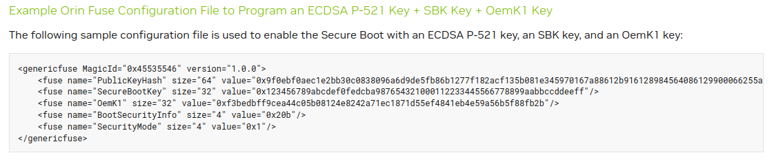

We have already designed a procedure to burn the fuses and we’ve successfully done for around 50 devices. We have just received some devices with non 0 content in BOOT_SECURITY_INFO fuse reserved bits. We didn’t expect that and get an error applying our custom value for such fuse:
E> Tried to set fuse bit 0 from 1 to 0
But OK, it’s our fault because it’s clearly explained in doc:
Bits [8:4] Reserved (may not be logic 0 by default)
Bits not listed are reserved
We’ve successfully apply our expected value by reading these bits, performing a logic OR with our custom value, updating our fuses file and burning the updated value. All right.
0x1e0 = 0...0 0001 1110 0000 -> already burnt bits 0x20b = 0...0 0010 0000 1011 -> our custom bits 0x3eb = 0...0 0011 1110 1011 -> updated with logic OR

Sure, I have bootloader images encrypted with SBK + PKC.
We have followed the official Nvidia Documentation to do so for Jetson Orin Nano as explained here: Secure Boot — NVIDIA Jetson Linux Developer Guide 1 documentation
Here, we are said to fuse BootSecurityInfo with “0x20b” and that’s what we were doing. It has worked on all the devices we’ve found until we’ve received some devices where BootSecurityInfo is not “0x0”
If I can’t use BOOT_SECURITY_INFO to set this information, as the official documentation says, how am I supposed to achieve same result without using this fuse? In the doc you’ve pointed there is no info about any alternative way to set this configuration

that’s due to recently, the fuse value for boot_security_info was burned (by manufacturing) to 0x1E0 as default value.
as mentioned above comment #3, those were “Reserved” bits.

it looks okay to program as 0x3eb for your use-case.

The problem is that we don’t know if the devices will come in future or other batches with those reserved bits as 0x0, 0x1E0, or any other value. That’s why we are unavoidably forced to read these bits and ‘make decision based on them’. Following this procedure:
  • Read the reserved fuse bits
  • Perform a logic OR with our custom value
  • Update our fuses file with the new updated value
  • Then, fuse them

please see-also Topic 330828. the fuse value for boot_security_info was burned by manufacturing to 0x1E0. it’s around in the beginning of 2025.
since they’re “Reserved”, for those reserved bits as 0x0 or 0x1E0 modules, you may program boot_security_info as 0x3EB directly for your real use-case.
Hello Jerry,
All right. Since the reserved bits may change, I understand that the procedure described here — Writing fuses with reserved bits - #8 by jetxeberria — is the best general approach for handling fuse burning when reserved bits are involved.
