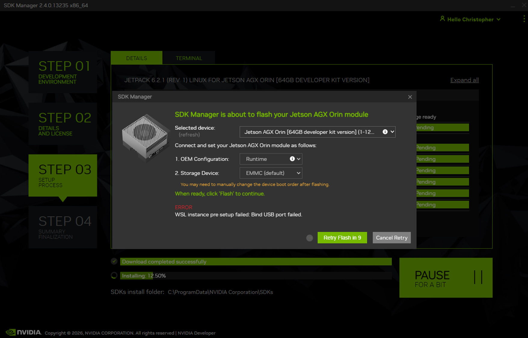

We’ve been using Jetson AGX Orin with JetPack 6.0 rev1 for about a year now and just started having trouble with it today. At first it wouldn’t boot, but now I can’t even get the BIOS or any text to show up on the screen when it is powered on (light).
I tried using the SDK manager to reinstall Jetpack, but even though I was able to detect the device I got an error.
“WSL instance pre setup failed: Bind port failed.”

Could you please provide the SDK Manager log files located at:
C:\ProgramData\NVIDIA Corporation\SDK Manager?
In the meantime, please try the following on your host machine:
  • Reboot the system.
  • Open NVIDIA SDK Manager.
  • Uninstall all previously installed SDK components.
  • Run the installation process again.
Let me know if you still encounter the issue and share the logs so further analysis can be done.

No luck on reboot. I tried on a ‘fresh’ machine and got passed that problem, but got a message that said,
“The target is in a bad state.”
I tried power cycling as suggested with no luck. Logs are attached below.
JetsonLog.txt (7.5 KB)
I’m still looking for solutions for both:
  • How to fix the “WSL instance pre setup failed: Bind port failed.” on my main computer.
  • If there is anything I can do about the “bad state” problem,

We have reviewed the logs.
For the first one, it seems like Bind issue may related to CsDeviceControl that is on your host device conflicts the usbipd. We will need further investigation.
The second “bad state” problem, please follow the instructions in SDK Manager to manually power cycle the device, change use port, etc. It may take serveral tries.
If it’s still not working, you may need to try to flash it with an Ubuntu Host or use some other flashing methods. Or consider if it’s a hardware issue.
