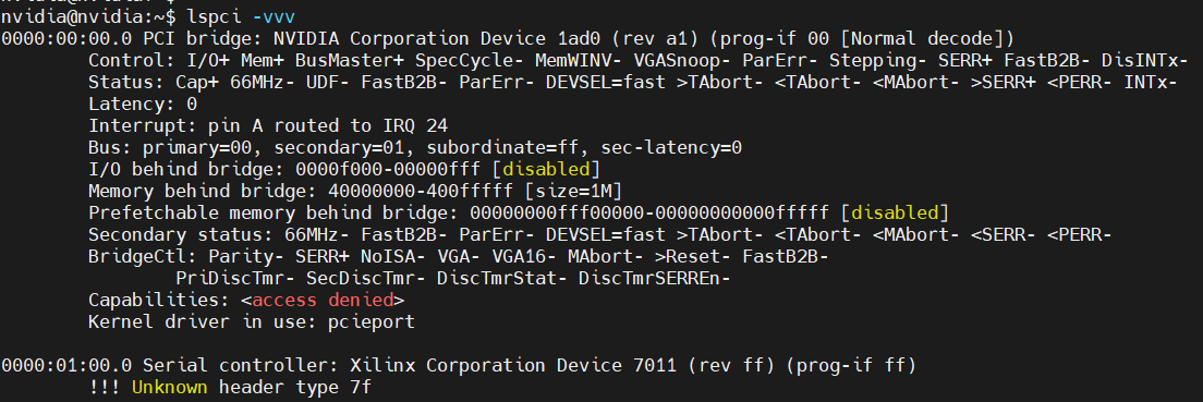

Xavier link PCIE C0 Error
PCIE_ERRORE.txt (83.3 KB)
Xavier R35.2.1
Use xavier pcie c0 have same error
Please refer to dmesg log
First, your lspci does not run with sudo.
Second, your dmesg is not full log.
Third, I don’t know who you are and what board design you are using. Please clarify your connection on the board but not just gave out a picture and one log file. And always keep this in mind. The people on forum are not your colleague. We won’t know what you are doing with just simple words.
dmesg_log.txt (122.2 KB)
lspci_log.txt (5.9 KB)
on custom carrier board PCIE_C0 link to FPGA, But an error occurred when connecting.
I re-uploaded the log file
AER erro would also require to use PCIe analyzer to capture the LA trace. Thus, please try to get one and dump trace.
