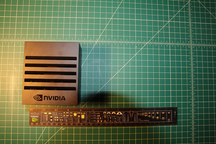

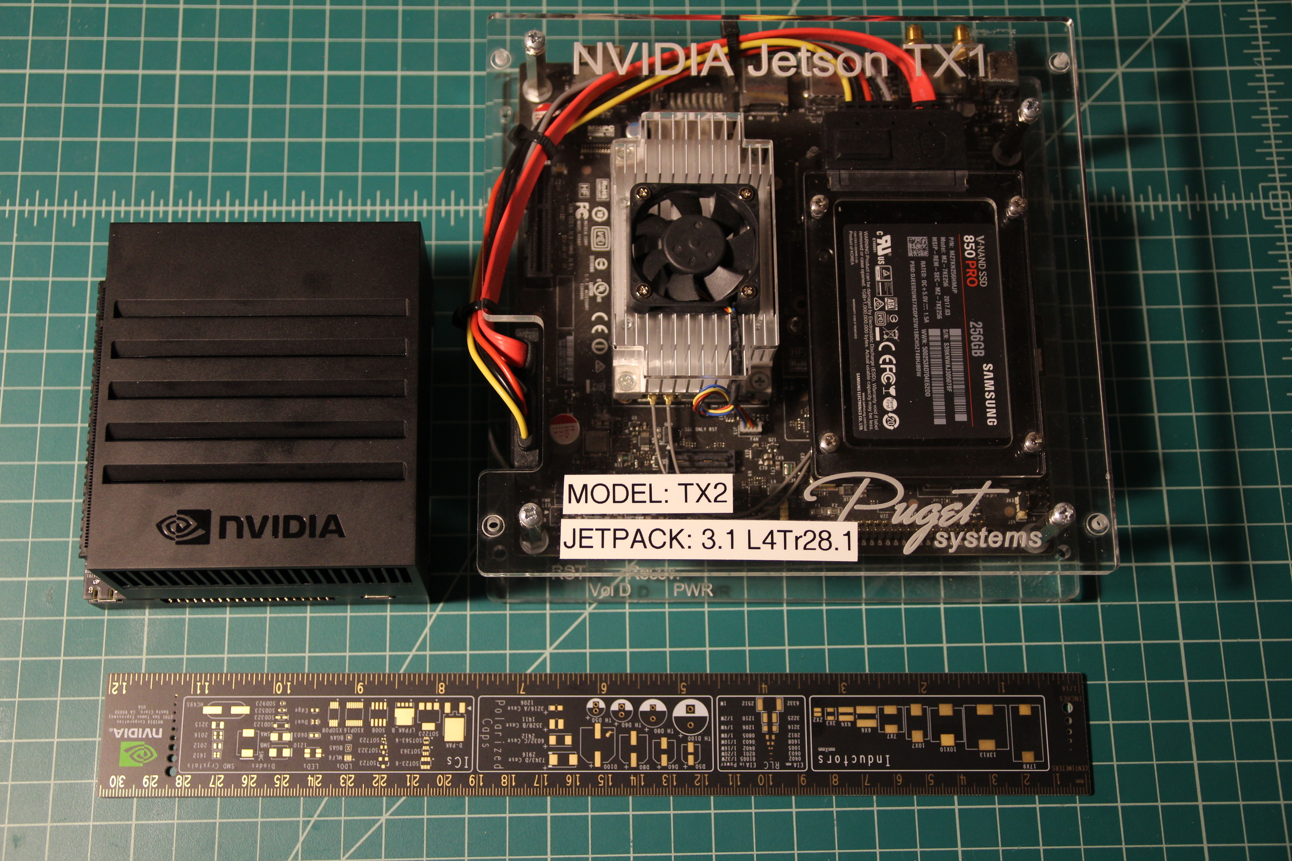

Over the weekend I did a basic teardown of the Xavier. Attached are my pics.

So you couldn’t get the heatsink off?
Found another picture of the heatsink off, though. Plus die photos!
The devkit has an integrated thermal solution that does not have the TTP (the OEM module will have the TTP), so it’s not recommended to remove the heatsink from the devkit unless you want to re-do the thermal pads and paste.
Negative. It is solidly attached. I even removed the fasteners. It is not coming out and I wasn’t about to pry it out either :)
I bet a hot air gun set below the solder melting point would do it!
Totally worth it.
DO IT! DO IT! :-)
Just Lol :D
If NVIDIA wants to provide me with a sacrificial Xavier, then I am game :)
