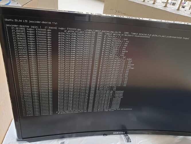

Hi I am using Jetson B01 kit, and flashed the image as said, but I am facing booting problem. After first time flashing it asked for user setup etc. but after applying changes the system rebooted and gave me below error:
Any idea what is wrong?
