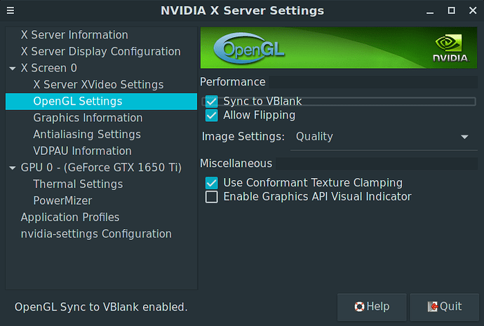

Doing so, I noticed that in nvidia-settings, X server 0 tab was also available besides GPU-0 tab. Also, In gameplays, the FPS displayed in corner was relatively higher(before adding config: 60-80fps, after adding config: 110-150fps (in CSGO)). But still, to my eyes the 144Hz is not like even 60Hz screen. I can feel that laggyness even when moving the mouse cursor. The www.testufo.com also gave 144Hz while it was not even 60Hz to my eyes.
When I remove the above mentioned config, the screen feels like 144Hz as in Windows and I can feel that even when moving the mouse cursor. But I dont get option of X server 0 in nvidia-settings. The main disappointment is I get low fps(60-80) in prime-run compared to Windows(120-150fps).

You need to enable prime sync by setting the kernel parameter
nvidia-drm.modeset=1
Since you have an AMD/Nvidia combo, you might also have to change
/usr/share/X11/xorg.conf.d/10-amdgpu.conf
to use the ‘amdgpu’ instead of ‘modesetting’ driver.
Thank you. Your suggestion worked. Now, it feels like 144Hz. However the gameplay is not smooth as it is in Windows. Is this expected or there could be some tweaks in nvidia configs that I could apply?

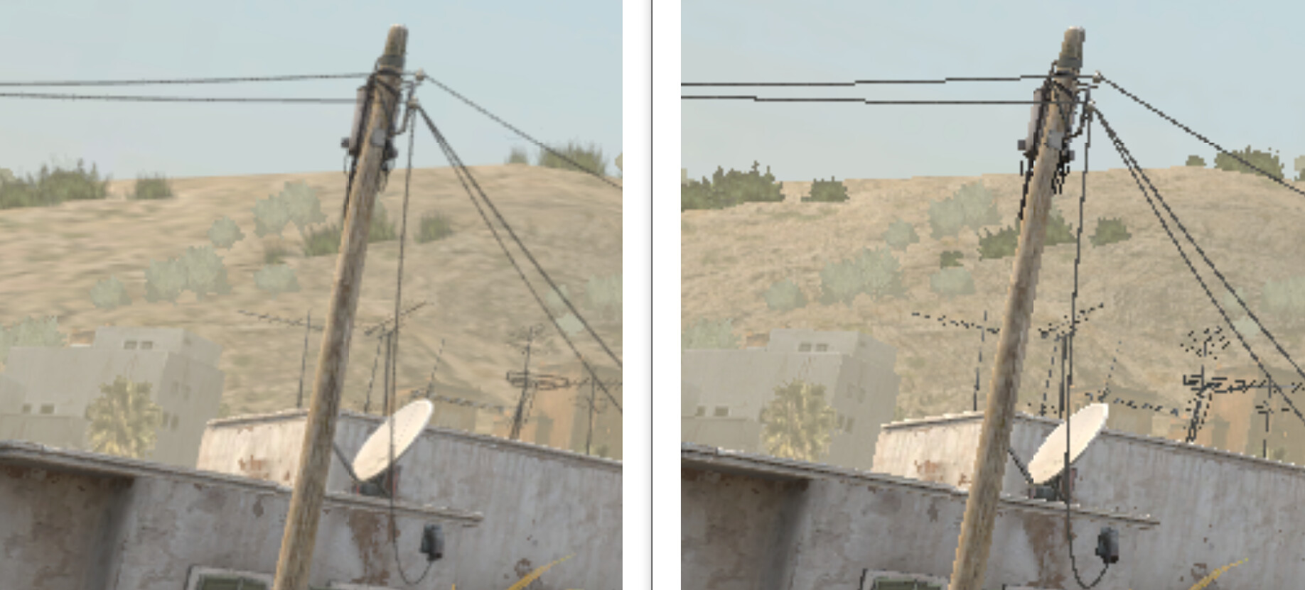

One thing I noticed is the lines are much jagged in linux. Is there any way I could fix this?.
Right one is of linux and left one is windows.
Never mind. I managed to fix this by setting FXAA anti aliasing enabled.
