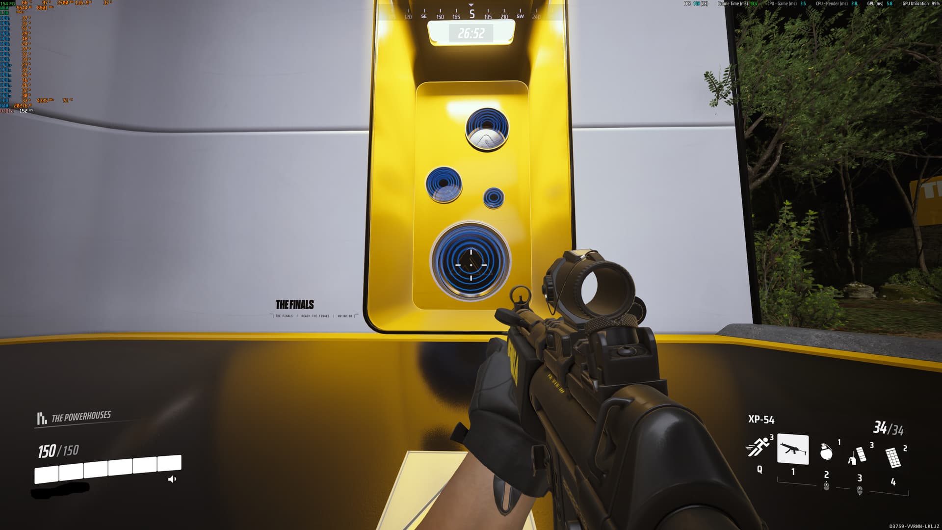

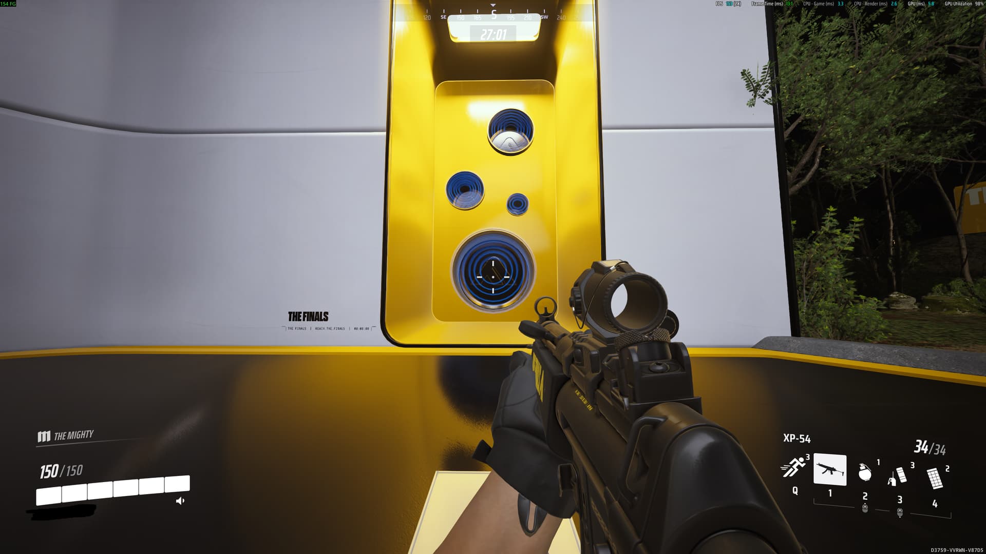

Settings: 4K DLSS CN Ultra Performance low preset
Here is Windows 11 with FG off:
Here is it with it on without a restart:
Here is it on AND after a restart:
Here is Afterburner’s overlay on, showing basically the same FPS as Steam and the in-game overlay.
All of these screenshots have Steam’s in-game overlay on which according to:
includes frame generation frames. Afterburner was started after the game was already running.
Nevermind frame generation being completely broken on Linux, it doesn’t even do anything on Windows either besides nearly triple the latency.
