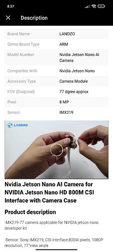

hello, I new here
I’m trying to run a camera on jetson nano 2 gb
But i get it:
Error generated. /dvs/git/dirty/git-master_linux/multimedia/nvgstreamer/gst-nvarguscamera/gstnvarguscamerasrc.cpp, execute:725 No cameras available
NvMMLiteOpen : Block : BlockType = 4
klog.txt (55.0 KB)
Thanks, Irra
hello IrraEi,
there’s probing failure to register camera device.
for example,
[ 1.311398] tegra-vii2c 546c0000.i2c: no acknowledge from address 0xc
[ 1.311612] tegra-vii2c 546c0000.i2c: no acknowledge from address 0xc
[ 1.311680] arducam-csi2: arducam_read: Reading register 0x103 failed
[ 1.311685] arducam-csi2 6-000c: probe failed
[ 1.311712] arducam-csi2 6-000c: Failed to setup board.
please contact with arducam to use the correct binary file to enable this camera module,
thanks
