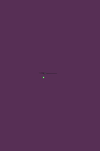

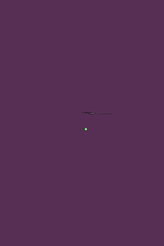

A hierarchy of objects moved seperately by the randomizer
Hello everyone,
I am new to omniverse, and trying to create training-data with a scene that has 2 objects in a hierarchy. They should move & rotate together (as the y do interactively), but when I run the replicator they move seperately. Anyone has an idea why?
I attached the omniverse-screen with the stage + script + basic-scene and 2 produced train-images
Thanks in advance

Hi @rami.mayer1 , rep.get.prims will get you all the prim under that path. Can you try to use rep.get.prim_at_path?

I am getting (with rep,get.prim) all the 4 objects under the path (“drill” in my case), but they move SEPARATELY with a different randomization values. I don’t find “rep.get.prim_at_path” in the documentation (I use API — omni_replicator 1.5.1 documentation ) am I missing it, or is there a newer version of the documentation?)

Hmm, the get.prim_at_path should be in in 1.5.0. The documentation is not updated. Can you check here?
https://docs.omniverse.nvidia.com/py/replicator/1.6.4/source/extensions/omni.replicator.core/docs/CHANGELOG.html
I moved to use “rep.get.prim_at_path”, and now it works!
