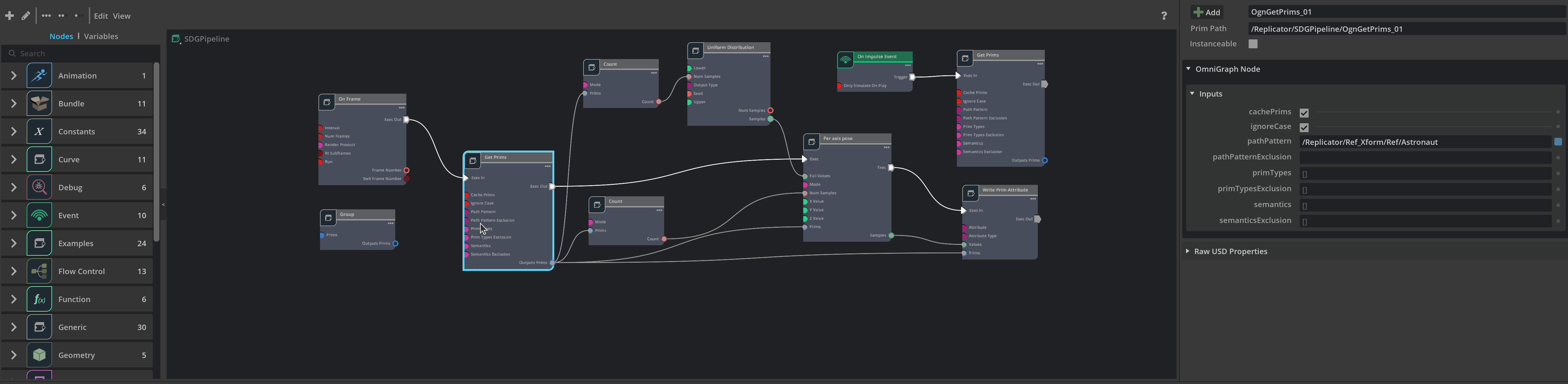

Here I’m just targeting the higher level xform prim for the purpose to moving the astronaut around randomly. It looks like it’s parent to all the other astronaut related prims.
The strange thing is that it seems to build this graph where it plans to move all the child prims as well as the parent xform which must be why may astronaut is dieing a terrible death.
So the question is. How do i just randomize the values of the parent transform without messing with the children?
