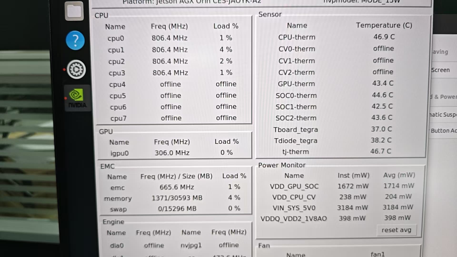

jetapck5.1.2,agx orin 32G,
gpu频率显示306MHz,为什么不是930MHz?
A question about the GPU frequency on a Jetson AGX Orin device!

  1. GPU clock speed variation: The GPU clock speed can vary depending on the system’s workload, temperature, and power consumption. It’s possible that the GPU is not running at its maximum clock speed due to these factors.
  2. Power management: The Jetson AGX Orin has a power management system that can adjust the GPU clock speed to balance performance and power consumption. It’s possible that the system is limiting the GPU clock speed to conserve power.
  3. Thermal throttling: If the system is overheating, the GPU clock speed may be reduced to prevent damage to the hardware.
  4. Driver or firmware issues: There might be an issue with the GPU driver or firmware that is preventing the GPU from running at its maximum clock speed.

By default dynamic frequency scaling is enabled. You may run $ sudo jetson_clocks to fix at maximum clock. And can run $ sudo tegrastats to check system status.
