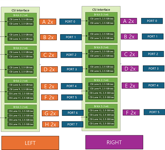

I am currently porting a GMSL camera to the NVIDIA AGX Orin.
Below is the system structure I intend to implement.
Also, I would like to ask which port number is correct in the diagram below.
Could you please let me know whether the left side or the right side is correct?
Also, regarding DTS configuration,
what should I configure if I want to set the port-index field to a specific value?
I have confirmed that ports A and B correspond to port-index 0 and 1, respectively.
I searched through the source code, but I couldn’t find any references to G port or H port.
What should I do in this case?

Both of them are incorrect.
The brick 2(EF) and 3(FH) only support one camera for 1x/2x/4x lanes configuration. However, the PORT # is correct in the right side.

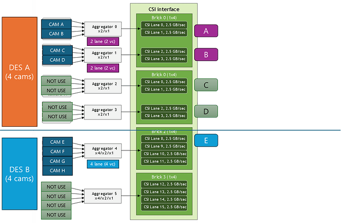

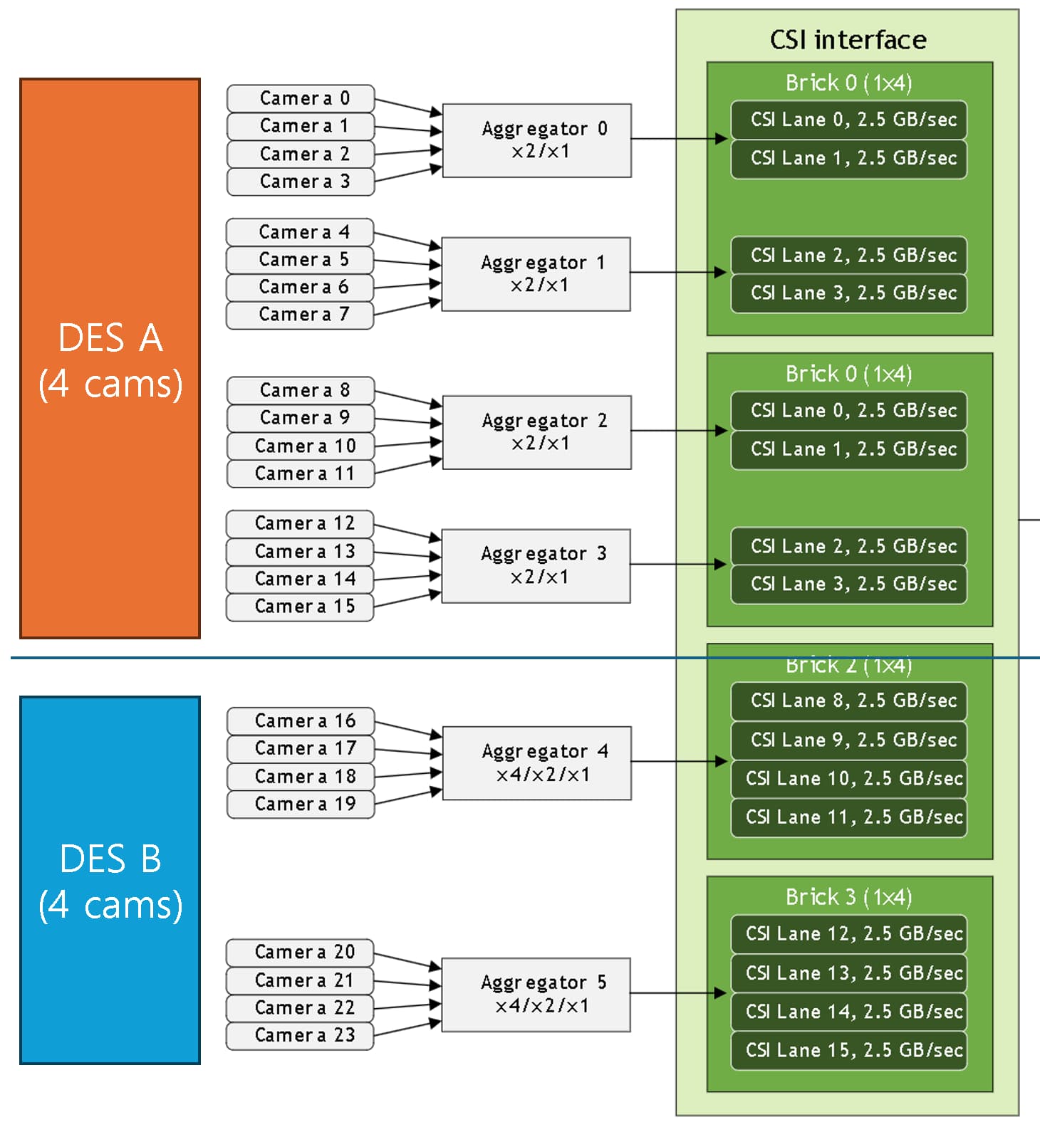

I would like to connect camera below diagram
It means deserializer A uses Brick 0 and Brick 1 and deserializer B uses Brick 2 and Brick 3.
Is it possible with AGX Orin?

This case should be fine for NVCSI/VI.

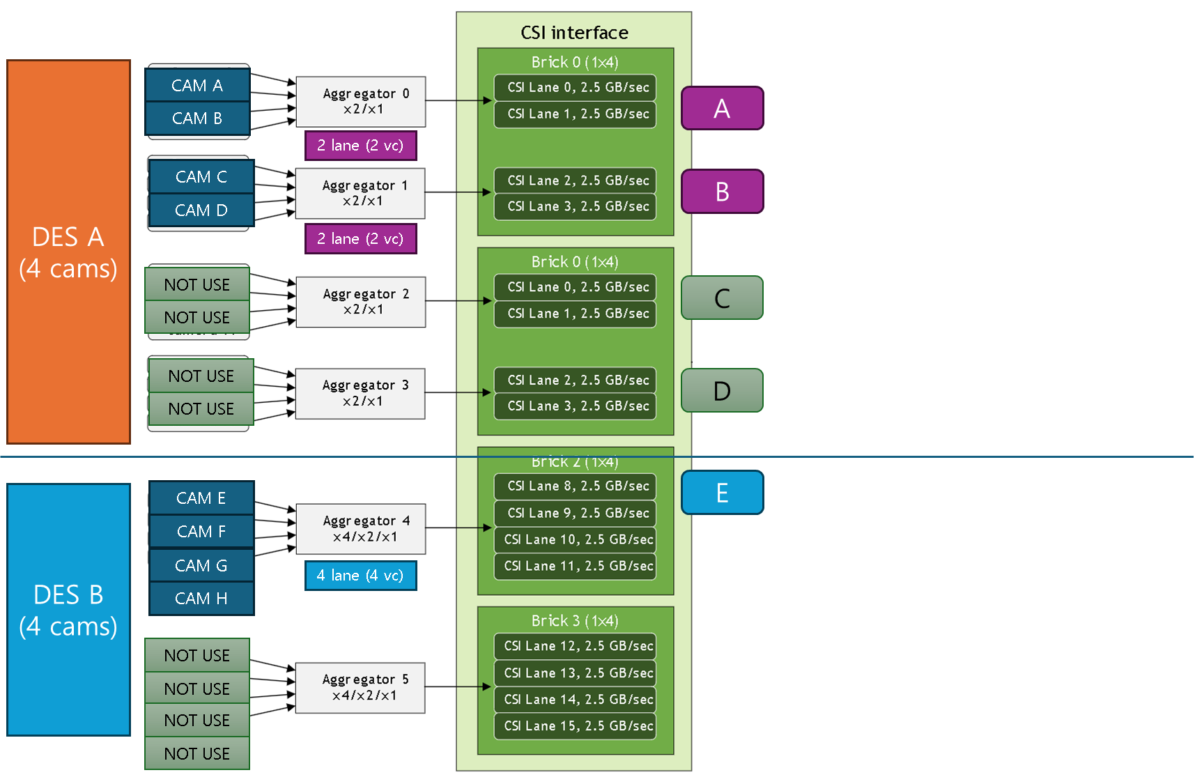

My system’s configuration is below.
Could you please review my dts configuration whether valid or not?
I attached my dts for above diagram.

Looks like no error for the port-index/bus-width.

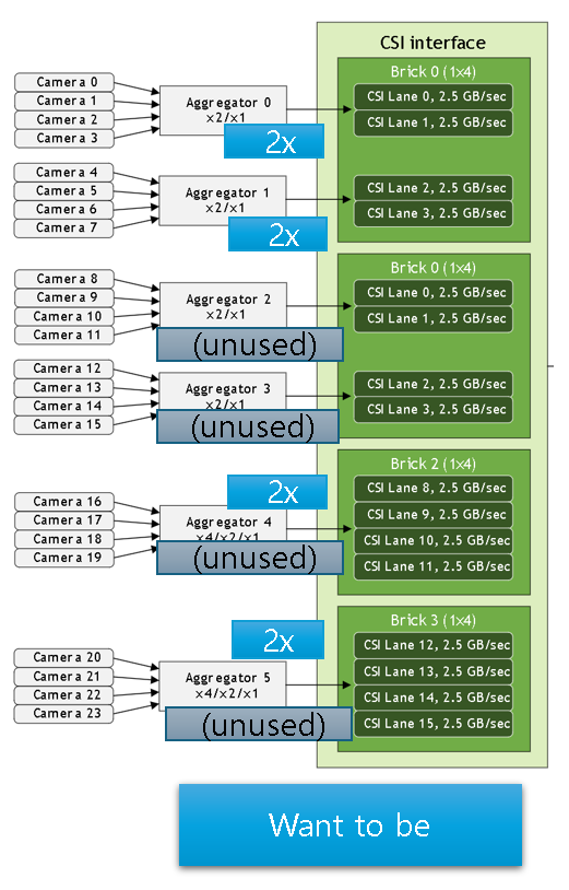

I have to change my system as below.

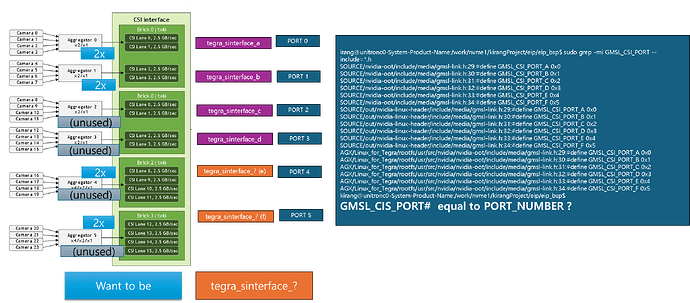

Could you tell me tegra_sinterface_? of the diagram.https://global.discourse-cdn.com/nvidia/original/4X/e/2/6/e26462f5e4d2af129bb81c2f3a90898604319206.png
Could you confirm whether GMSL_CIS_PORT# is equal to PORT NUMBER of the diagram.
Could you tell me below picture’s dst-csi-port for orange colored tegra_sinterface
I know values for tegra_sinterface_a,tegra_sinterface_b,tegra_sinterface_c and ,tegra_sinterface_d

Could you tell me for tegra_sinterface values for orange colored box?

I don’t have idea for the dst-csi-port-* but the tegra_sinterface is like mapping like below.
port-index tegra_sinterface
0 a
1 b
2 c
3 d
4 e

for port-index 5 → tegra_sinterface must be f, am I right?
Usually EF/GH bricks only support one stream for 1x/2x/4x
And usually start from CSI-E.
CSI VI tegra_sinterface
0 0 a
1 1 b
2 2 c
3 3 d
4/5 4 e/f
6/7 5 g/h
