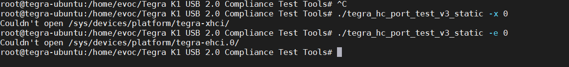

但实际测试的时候,并不顺利,主要问题有2点:
1.执行./tegra_hc_port_test_v3_static 报错,是否这个工具太旧了?我用Sdk是R3560

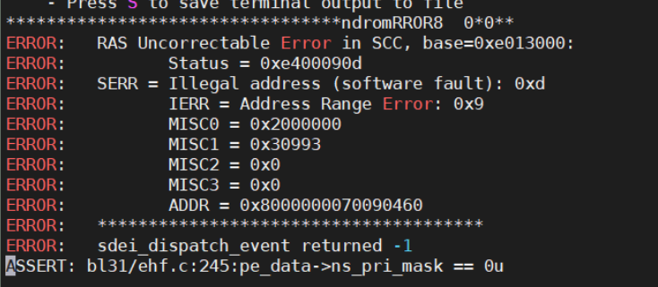

2.使用devmem读写文中所说的寄存器,会直接死机
命令:sudo devmem2 0x70090460,输入后内核立即卡死,并且串口打印:

We want to test the signal integrity of USB 2.0, and we need the corresponding packet generation tool. However, the documentation and tools provided on the official website cannot be used properly. For example,:
1.when I execute the command(sudo devmem2 0x70090460), the system will immediately crash.
2.“tegra_hc_port_test_v3_static” If this command is executed, the following error will occur
