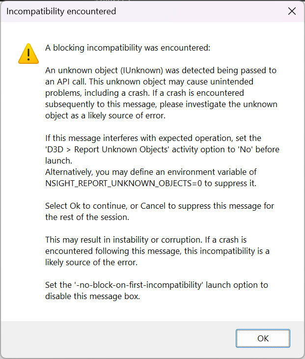

I’m currently using NSight Graphics 2025.4.0. When I run my application under NSight, I get this pop up every time:
I have set the environment variable to 0 like it suggests, and there’s no change. I looked for the option under D3D > Report Unknown Objects, except that under the new Graphics Capture system, there is no such option. I tried setting the value to No under the Frame Debugger system, but it had no effect.
I suspect it has something to do with the call to D3D12CreateDevice which takes an IUnknown* parameter because it can be a number of types (I have no choice in this, this is Microsoft’s API design).
This seems like a bug to me, I am definitely not using IUnknown beyond that function call and my application does nothing more than clear a swap chain and present it, so it’s very very very simple.

This happened while using the Graphics Capture activity. It does not happen when I use the old Frame Debugger.
Regardless, there’s a miscommunication here. What I’m trying to point out is that there’s no way to suppress this message popup from the Graphics Capture activity, while there most certainly is in the old Frame Debugger activity. The instructions on the pop up are incorrect.
The info in the dialog looks confuse, could you please try TroubleshootingBlock on First Incompatibility and set it to No.
I will create an internal case to track the confuse dialog issue.

This works, it turned off the pop up.

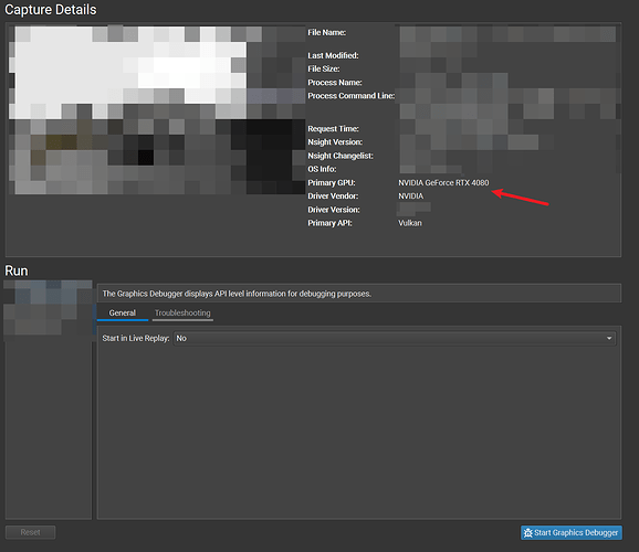

If you open the saved file of Graphics Capture activity (*.ngfx-capture), you should see the GPU info on the up right panel. For example, here is my screen shot.
An
Thanks AYan.
What I was getting at however wasn’t that it should be visible somewhere in the tool, but rather that the current warning dialog given in the top post is misleading and confusing to users.
It makes a statement “An unknown object (IUnknown)” which is problematic since all COM objects are IUnknown. It then only discusses is being “unknown” and provides a suggestion on how to disable it if it causes problems, but does not actually attempt to indicate what the actual problem is or provide any context as to what failed validation.
The tooling could have validated that it was in fact some IDXGIAdapter (as the underlying D3D12CreateDevice call expected) in the first place and simply stated “An unknown adapter” instead. Even better it could have explicitly stated that the adapter, printing the adapter name returned from IDXGIAdapter::GetDesc, is not recognized as an NVIDIA device and so may not work with the NSight tool, which is the actual problem and the reason for the failure.
This would provide a significantly better and more actionable user experience, leading developers into a pit of success rather than a pit of failure. Particularly since handling this scenario and printing an actionable diagnostic is a handful of lines of code instead.
Some update:
The miss leading words in Incompatibility encountered dialog box has been fixed, next release of Nsight Graphics will pick that.
