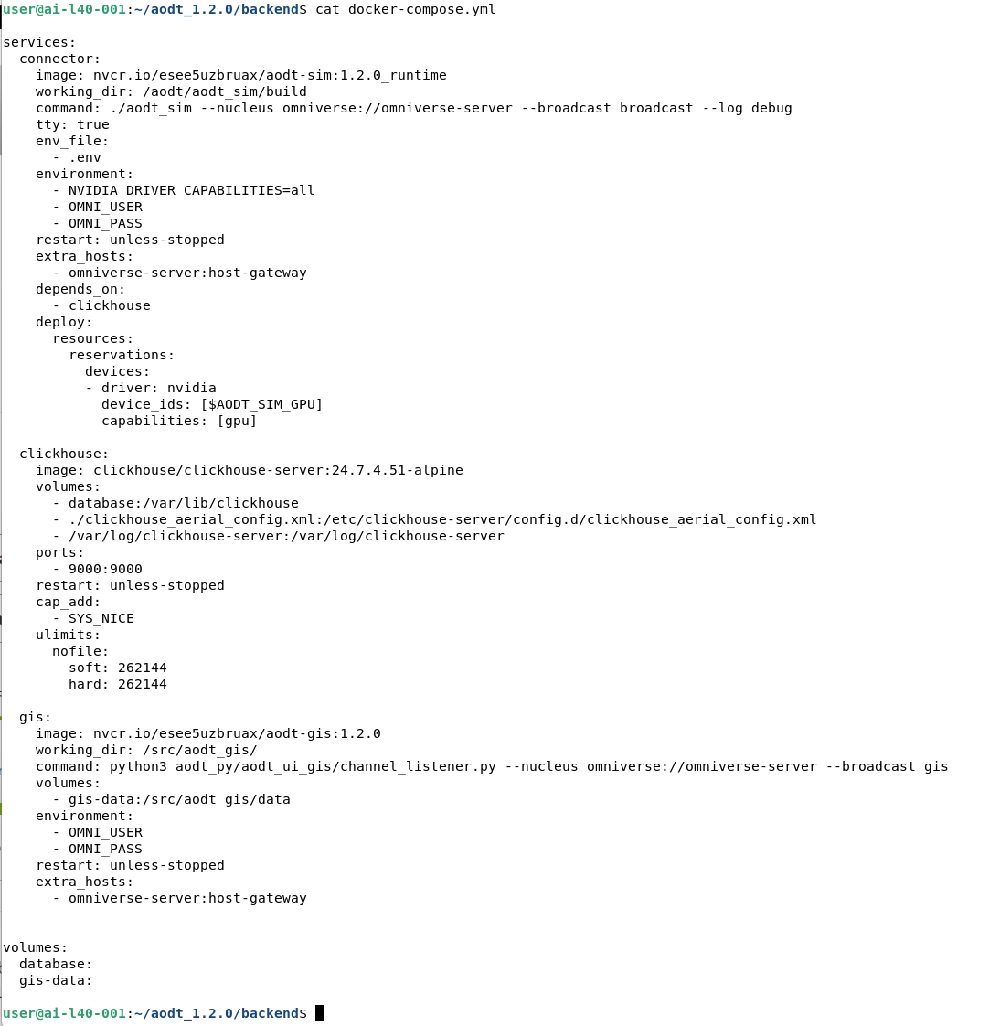

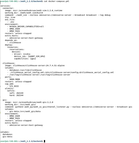

Hello, my backend directory does not have the docker-compose-exemplife.yml file, only docker-compose.yml, as shown in the screenshot below:
Sorry for the error on file name. Yes, use this file.
