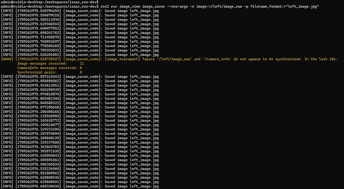

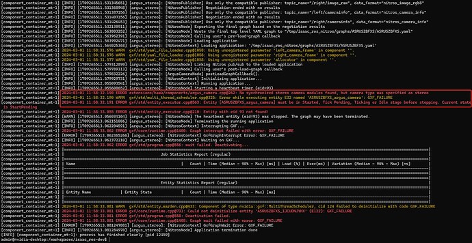

Our ultimate goal was to run Isaac ROS Visual SLAM, but when running the Issac ROS Argus Camera, we ran into the following problem.
Launch monocular camera, running properly. can save left_image.jpg.
Launch stereo camera. Error reported. as follow:
log as upload
isaac_ros_argus_camera_stereo_log_20240301.txt (13.9 KB)
Hi @edu118
Ths streaming coming from the device developed looks not syncronized and the stream fail.
How did you setup the Devicetree?

The failure is due to following property missing in your camera device tree:
sync_sensor_index = <1>;
Try adding this and verify with argus_syncstereo directly.
You can refer to the device tree for HAWK (AR0234) to see how we did this here:
t234-common-modules/tegra234-camera-p3762-a00.dtsi
