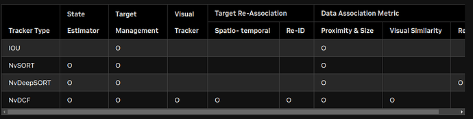

What I mean is that when the object has completely disappeared, a new object appears. The old id_object is re-allocated to a new object. I want the time period to reuse the old id_object for the new object to be 3s, or not reused. used the old id_object, but nvtracker reused the id_object in a very short time of about 500ms. How can I use incremental id or increase id_object reuse time
nvtracker will assgn new object id for new object. Can you share some picture of video to show nvtracker will reuse old object id?
Seems you want to disable re-association: Gst-nvtracker — DeepStream documentation 6.4 documentation . Can you share your nvtracker configure file?

After reading the document, I changed maxShadowTrackingAge = 1 and did not encounter the problem of repeated object_id. Is it correct to change the config?
IOU not support re-asociation
Yes, you are right. maxShadowTrackingAge will keep the target alive longer even if the target disappear.
